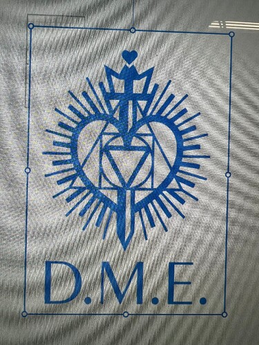

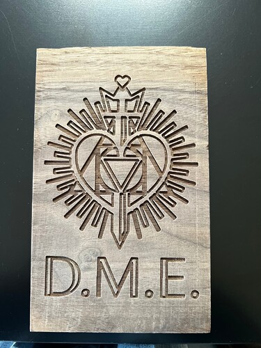

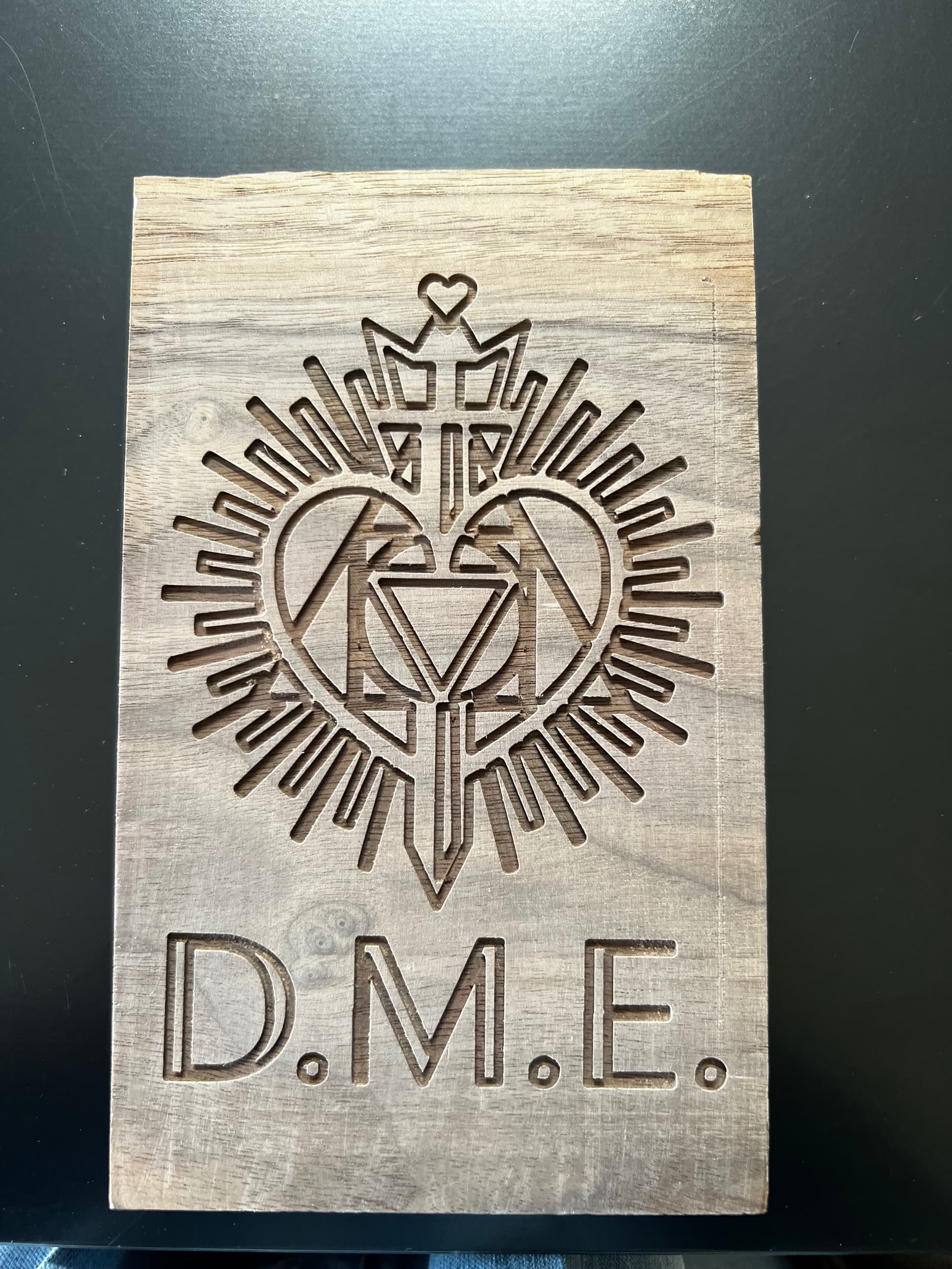

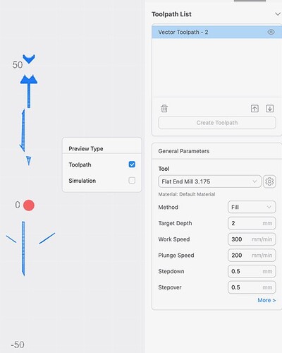

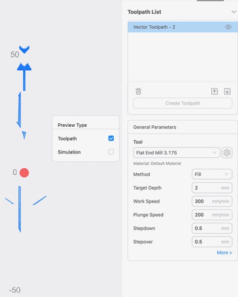

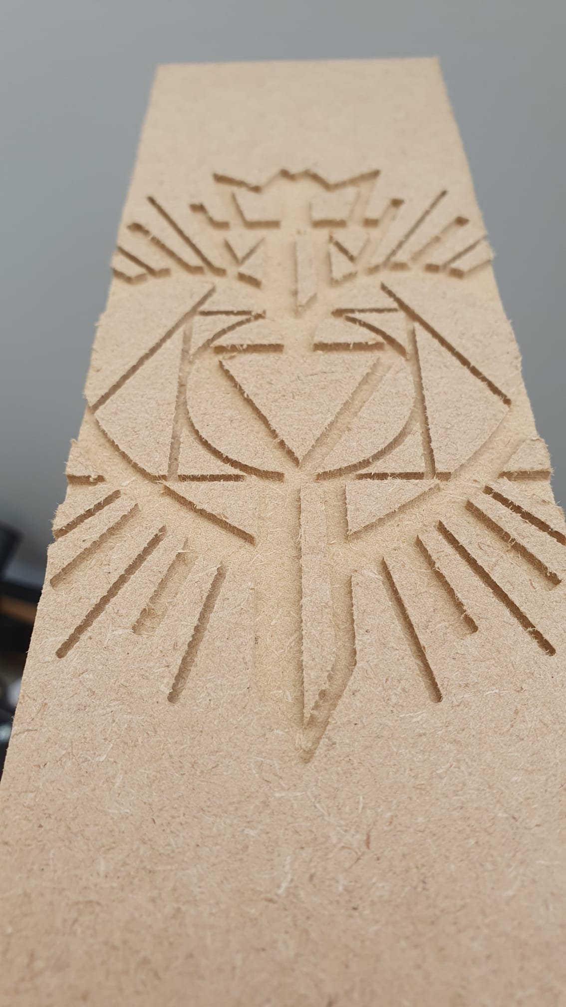

Why doesn’t this file convert correctly to a tool path? I tried cutting in vector but it left some areas uncut as in the third photo. The first photo is what it looks like on Luban before I generate code. The second photo is what it looks like after it converts
You have ‘Cutting on the path’ selected. This is part of the Vector profile, which is incorrect for your image.
It does this when set on fill also. Do you have any other ideas what might cause this?

It looks like your toolpath has followed the periphery of all your black areas. Luban is pretty basic in that you can only choose On the Path or Outline (what ever that means) or fill (with a zig-zag pattern that doesn’t even follow pseudo paths, that doesn’t take much thought!), not even ‘inside the path’. I once had to do a fill first and then a separate toolpath as an outline to clean up the remains of the zig-zag rough edges.

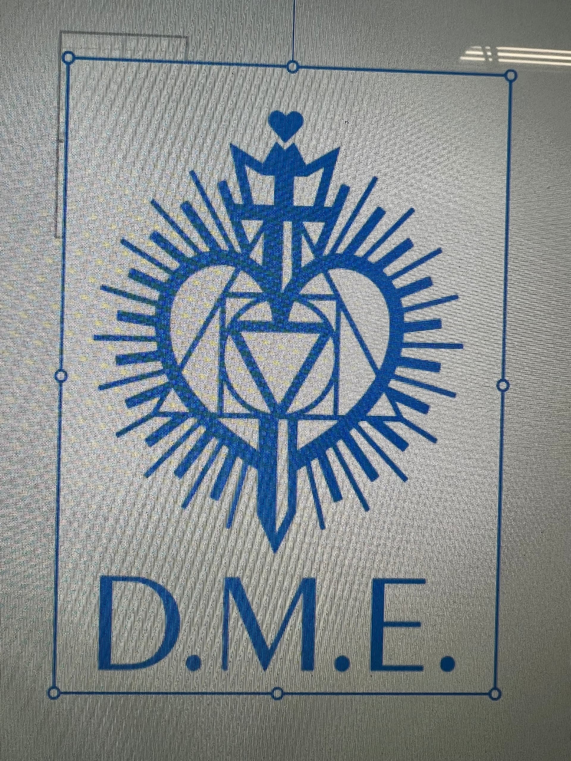

Yes the image lines are larger than the tool diameter. Here is the file if you would like to try. So what you’re saying is Luban doesn’t have the capability to design the cut but can cut it if it is designed properly?

As I thought, it’s almost certain that the tool diameter you have used in your toolpath is too large for most of the elements of the image. That is why much of it is disappearing in the preview.

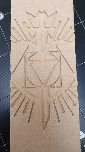

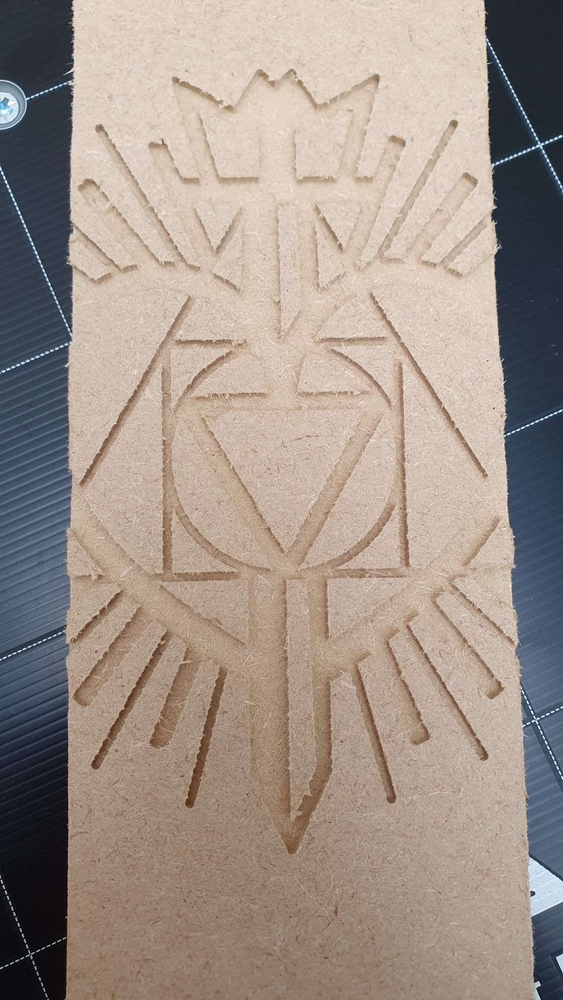

You said you want to cut the image at a total width of 3". I have tried it at 5" wide and found that a cutter of 3.175 causes various areas to not be processed. I have done it with a 1.5mm cutter with success for a 5" image.
But, shrinking the image down to 3" wide causes much of the tool-paths to go missing. In fact only a tool diameter of 0.9mm or less will work when the image is 3" wide.

  1. When you choose the Vector ‘Processing Mode’ you then need to choose the ‘Fill’ Method. It’s a very inefficient tool-path, all the zig-zagging, but at least this mode also creates a tool-path that runs around inside the boundaries therefore cleaning up all the mess from the zig-zagging. I don’t know why they couldn’t create a mode to produce this ‘inside path’ tool-path separately.

I scaled the image down by typing 76mm in Luban for the width of the image, if you do something slightly different you may get away with 1.0mm or be forced to use 0.8mm - when you generate the preview look for the thinner lines disappearing.
This is the 5" image done with a 1.5mm cutter on a scrap piece that wasn’t quite wide enough…
I prefer yours though :blush:
