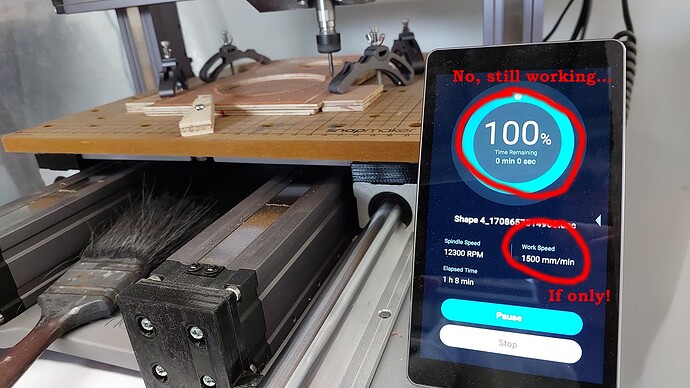

Why can Luban not calculate the remaining time for a job?
Why is it that if I send a laser or cnc job to the machine the estimated time
will be calculated and shown on its little touchscreen,
but when I start a job via Luban it cannot do the exact same thing?
Luban is not aware of the machine specific acceleration and junction deviation limits, so it can’t get an exact answer.
That being said, it can guess at a time remaining, as many software packages do, so the answer is the developers chose not to implement it.
Further to this, I see the error for time elapsed still exists. Also, I wish my CNC could go that fast… :rofl:
The 100% comes up after the mill has finished cutting the first object in the project. Any further objects are cut, but the display incorrectly shows complete.
BTW, the work speed should be showing 70mm/min and it does sometimes, but when the work surface is moving away, with no x-axis movement, it shows this epic speed!
