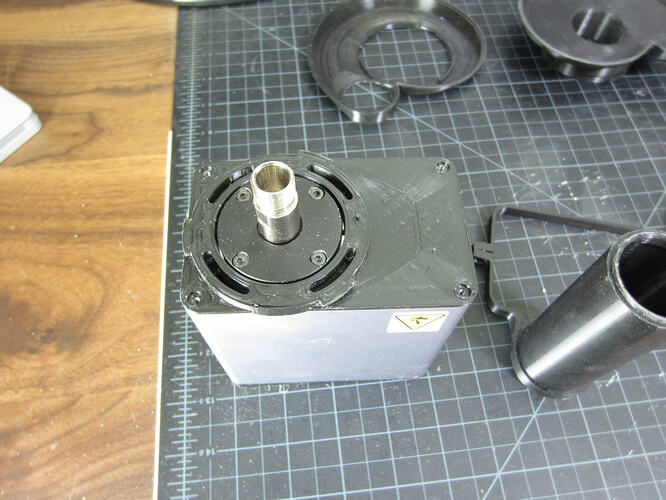

Here are the installation instructions:
  1. These are the printed parts.
  2. Glue the halves of the pump housing together.
  3. Place the mount plate on the CNC head.
  4. Mount the CNC head to the Snapmaker.

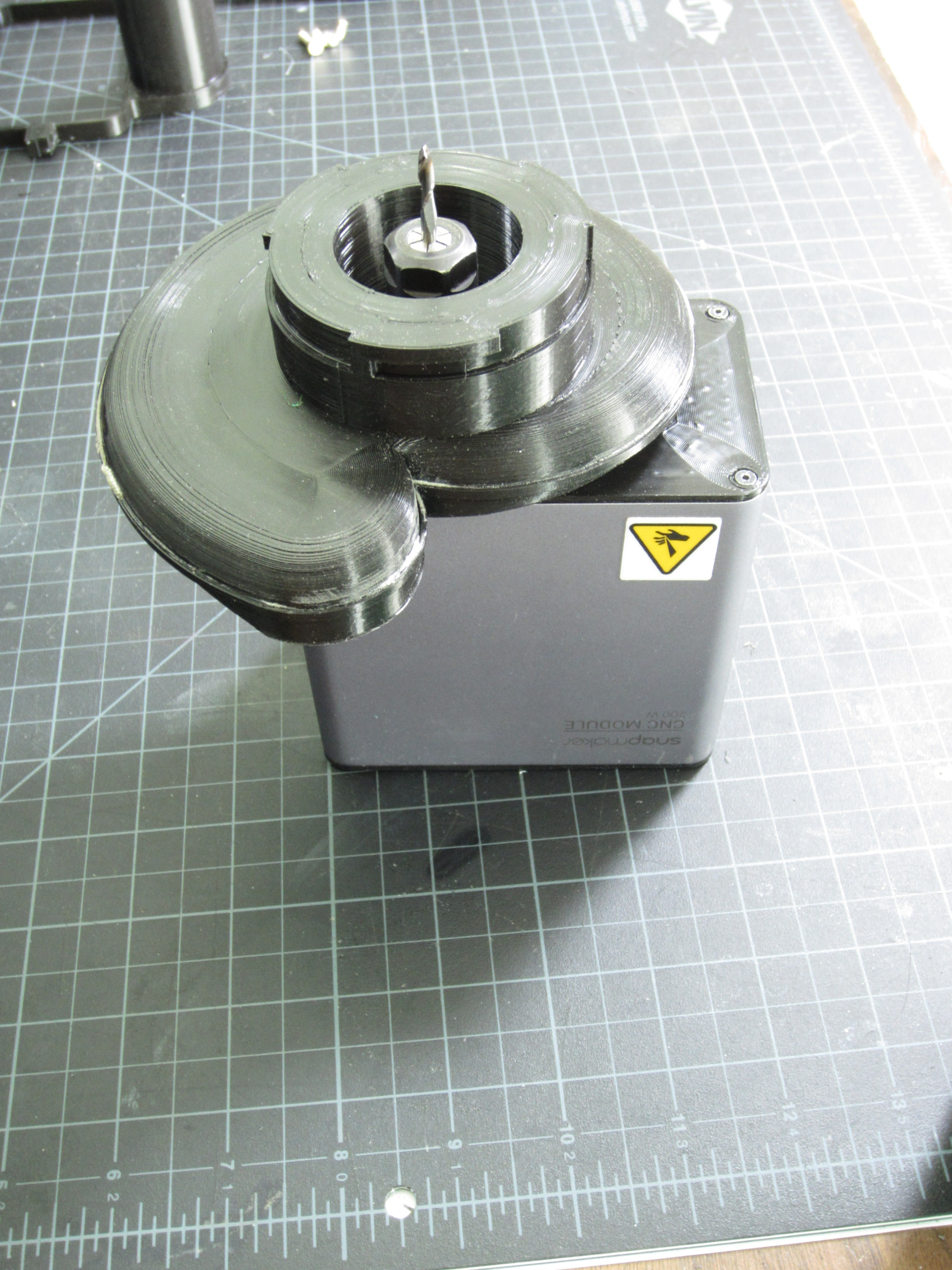

  5. Insert the Impeller onto the spindle.
Ensure the slots are aligned properly! The open slots will align with the slots on the spindle or the spindle will not seat into the impeller!
  1. Install ER11 nut and bit, tighten as usual, using the slot in the impeller to place the wrench.
7a. Slide the pump housing onto the mount.
7b. Twist the pump housing to secure it.
7c. The pump housing will stop when aligned.
  1. Insert pipe to secure pump housing.
  2. Tighten strap.
  3. Mount your preferred brush attachment.

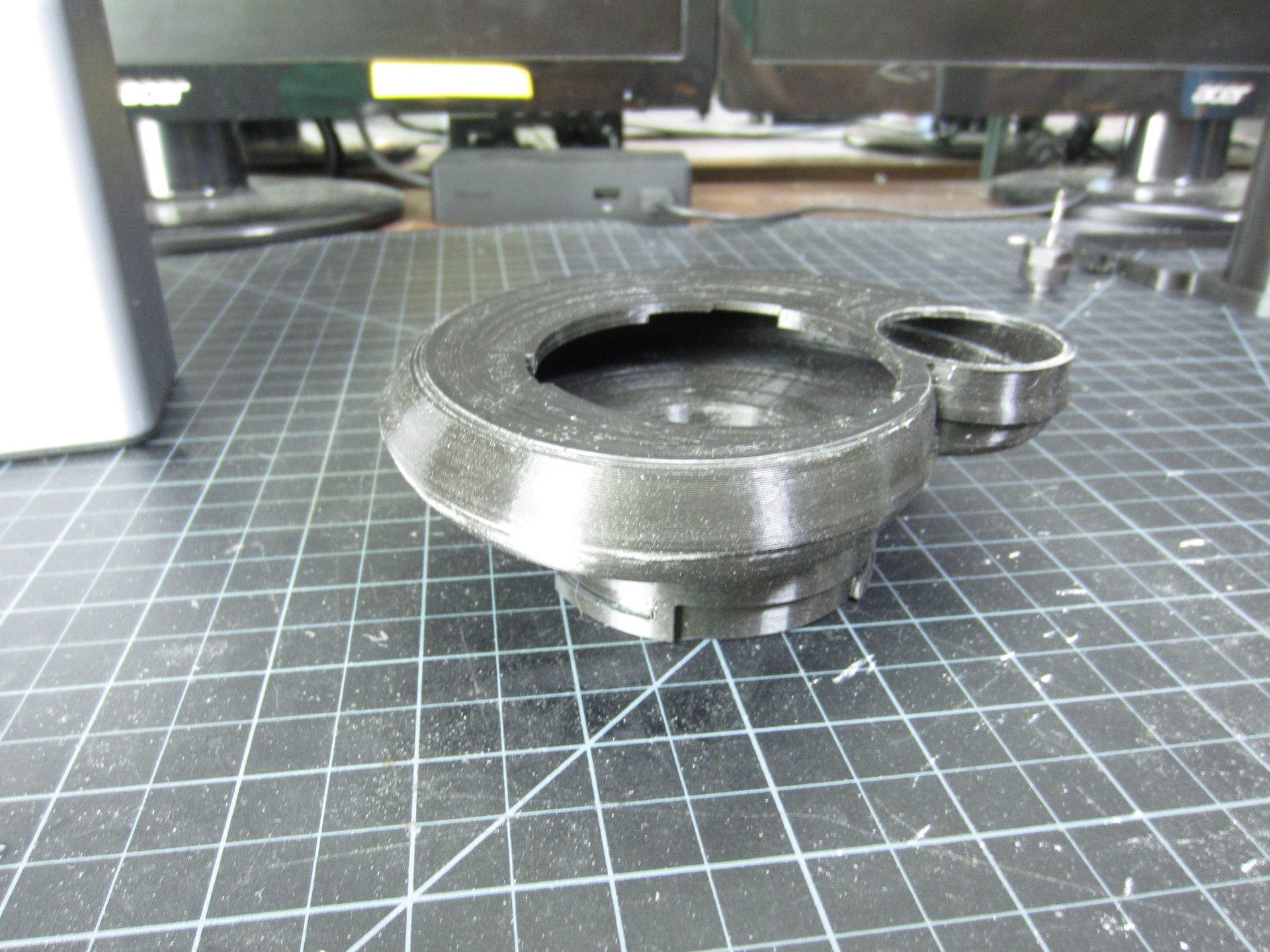

Just a few of the failed prototypes on the way to the version 2.0 upgrade:
Have you any details of how you support or orient your printing as I wonder if it would be effective to split some of the parts for easier printing particularly the large duct part? and maybe simplify the base of the impeller?
