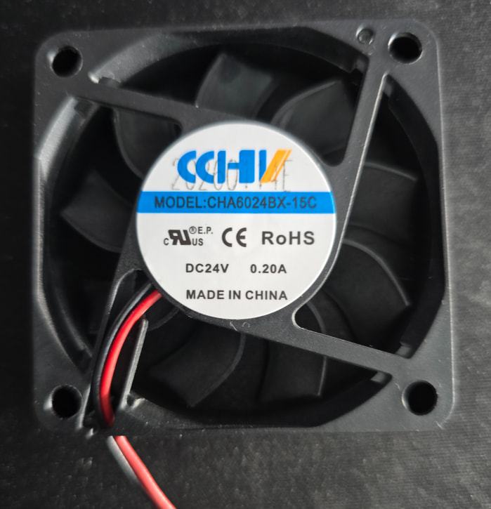

This is just a little post to let you know that I cannot stress enough how nearly mandatory it is to mod the PSU fan in the U1 if you keep the printer in the same room as you. Switching to a Sunon MF60152V21000UA99 (under 10€) and removing the plastic grille on the PSU cover not only made the U1 so silent that I was worried the fan wasn’t running at all, but even the stepper drivers benefit from the improved airflow and run about 5°C cooler (around 78°C instead of 85°C for the same print).

could you please post a link with a tutorial if you have it? The fan model you posted works with 24Vdc but the Psu fan works at 12Vdc,right?

If a fan rated for 24V works at 12V (I expect it will), that will contribute to its quietness.
yes but its airflow will be less than half… so quiter but unuseful and also dangerous
you all would be absolutely right abour half rotational speed, half air throughput and potential hazard if the original fan would have been 12V.
But, in fact, it is 24V. At least in my U1.
Picture of the fan in removed:
Mostly, to cool electronics doesn’t require a huge airflow – just some airflow.
