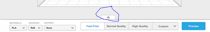

I would like to use another filament, with a different temperature specification. How can I change the temperature?

Doug the newbie here, have you seen the Custom settings in Snapmaker3D ?

Did you press the up arrow and the foot of the screen?
This will show you the custom settings greyed out.
Then move across and select Custom and then click on the Custom popup.
Then you see all the custom settings highlighted and allow you to alter them.
