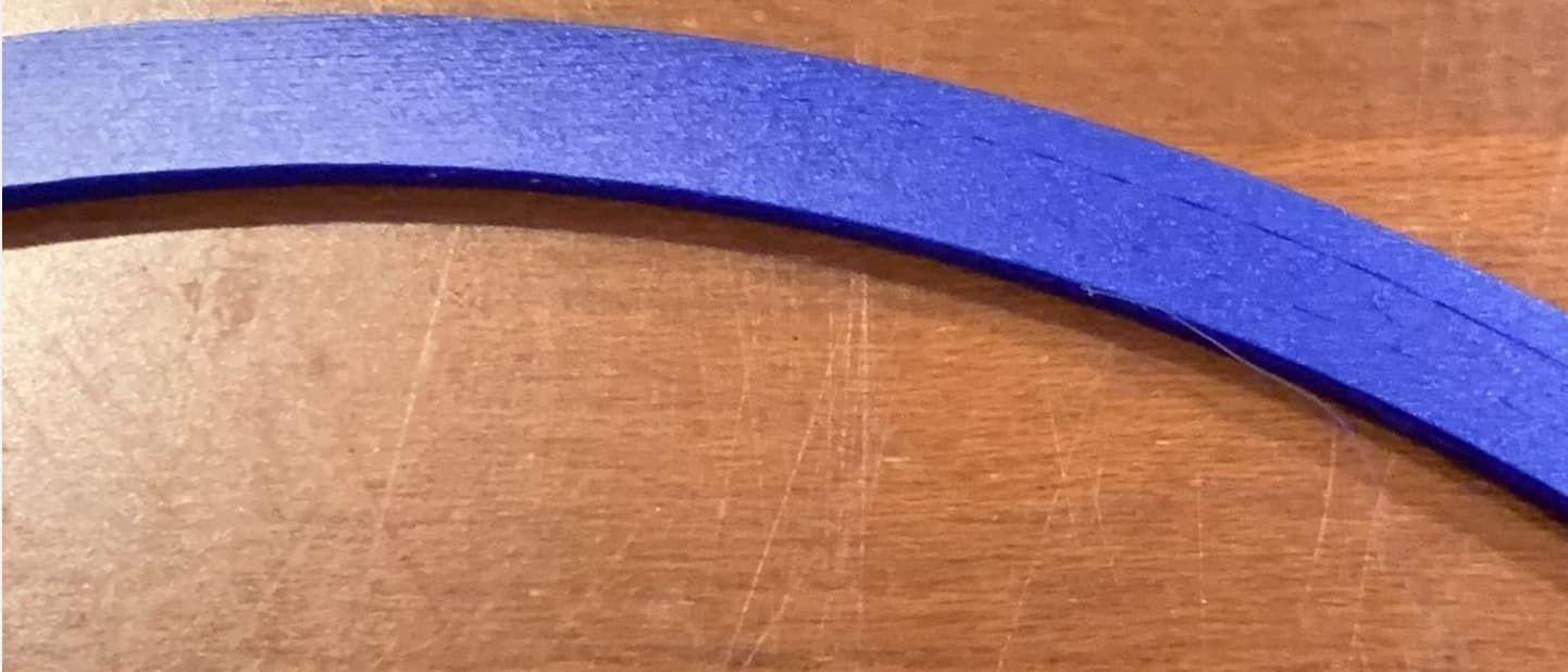

issues with printing - no it prints just fine, visible markings on the first layer, absolutely.
try moving where you print the round thing, and raise your z offset by +0.05 or even +0.1

before you begin looking at these note i am not happy with this blue hatchbox filament and i don’t think its fully dialed in on my machine (you see some evidence of warping - it seems super sensitive to that), i also haven’t done Y backlash since getting new rails. As such i think i could dial it more, but for my purposes this is mostly as good as i need, it also feels much smoother to the touch then it looks. I am also not happy with flow rate as a flow calibration cube implies i need to be at 1.38 multiplier, but that is nonsense as it makes full object nasty. This was printed at 1.12 flow multiplier (i am still messing with flow). Also had unexpected stringing so my nozzle temps may be a tad too high at 200 for first layer.

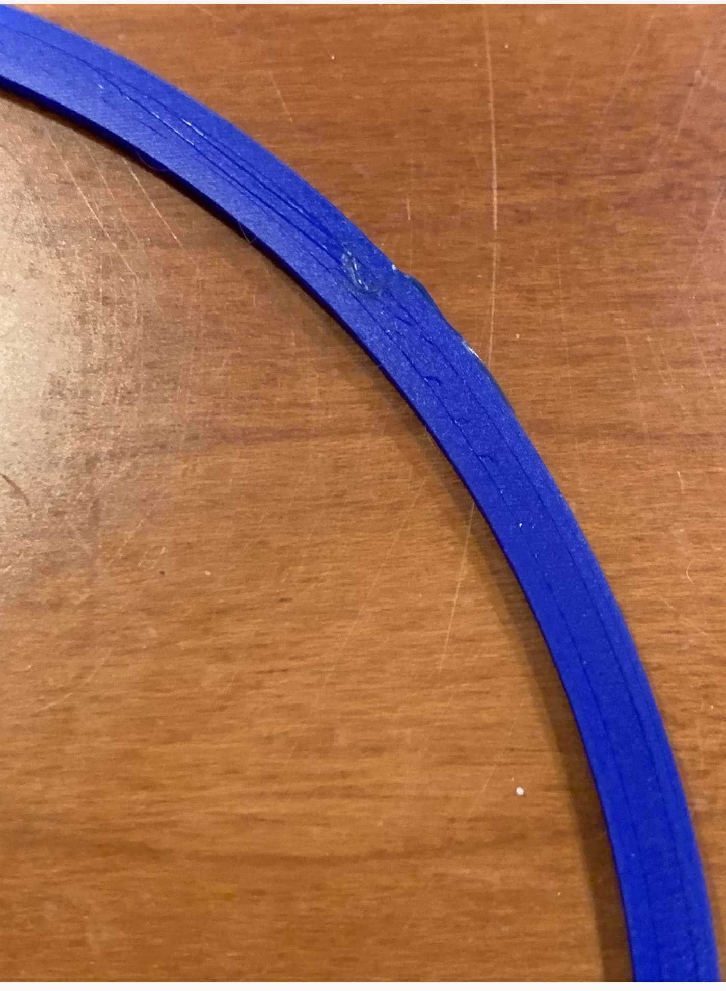

pretty sure the divots above caused by nozzle dragging over first layer (see my other weird bed leveling inconsistencies)

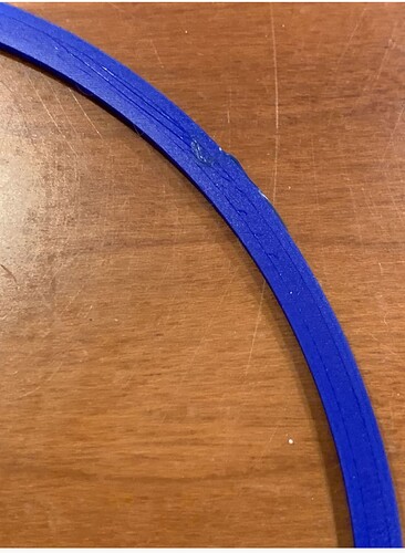

not sure whats going on here, looks worse in picture than real life, based on experience i think this is just normal artefacts of using FDM printer. --edit-- oh this is where some stringing created a micro-blob i removed mid print with my finger nail…
i consider this result pretty near perfect with some room to maybe dial in some more quality.
Interesting results. Glad to see it’s not just me with the issue. I agree with the print head gouging (saw it while printing), but is there anyway to stop this?
Makes sense. I wonder if this would fix the head gouging into the first layer?
