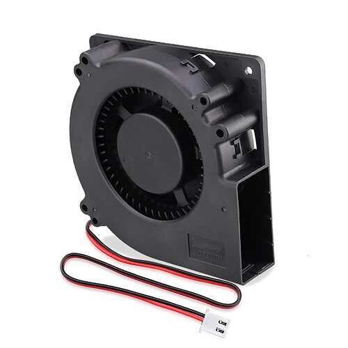

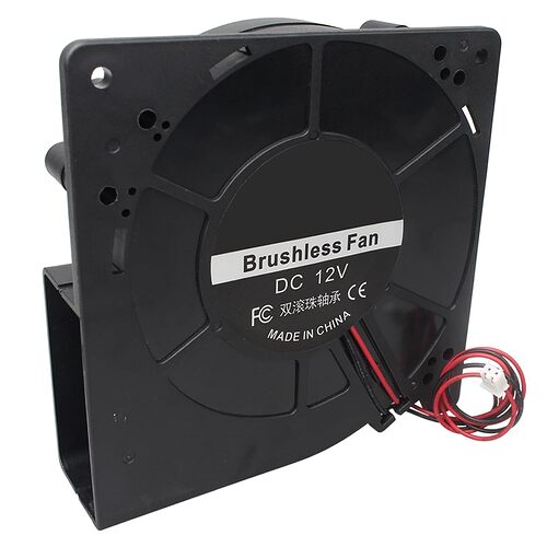

Do you happen to have a photo of how you attached the concrete box to the Samsala box? How did you handle the power supply? Do you have a photo of that as well? If I’m reading it correctly, you’re using the 120mm radial version. Do you have a link to the compatible fan? On MakerWorld, only the US shop page is linked.
Thanks for your feedback.
I’m currently on vacation, so unfortunately I can’t post any pictures of it.

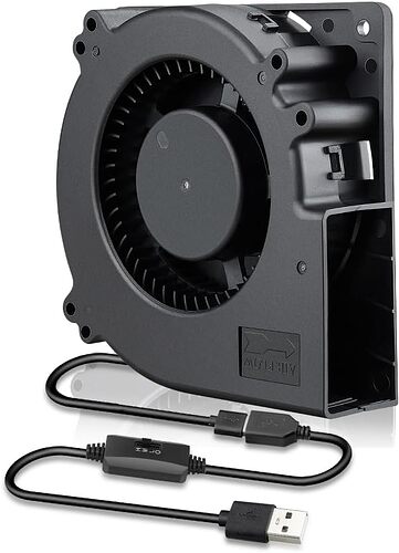

I attached the Bento Box to the front of the SAMLA box using heat-resistant 2K adhesive (the lower fan segment) and drilled a small hole for the -caution- 12V fan power supply. For this, I also mounted a 5-12V regulator with a potentiometer on the lid with a hole to control the fan speed. The power supply is an old 12V 2A unit from a WD HDD, which I control separately via TP-Link/Shelly - just like the printer, to perform a “hard” restart after a firmware update…
You can use the following fans from Amazon DE:
or
or if you want to use it externally with an old +5V USB power supply:
I would absolutely not recommend powering the fan via the printer’s internal power supply - this can cause nasty side effects. I’ve had very bad experiences with this on my X1C and also the K2plus: the fans can, among other things, cause high-frequency interference on the board voltage, which can make the printer controller act up from time to time…
Therefore, anything that requires separate voltage on the printer (fans, USB hub, LED lights, etc.) should also be powered separately/externally - this results in significantly less plastic waste :wink:…
