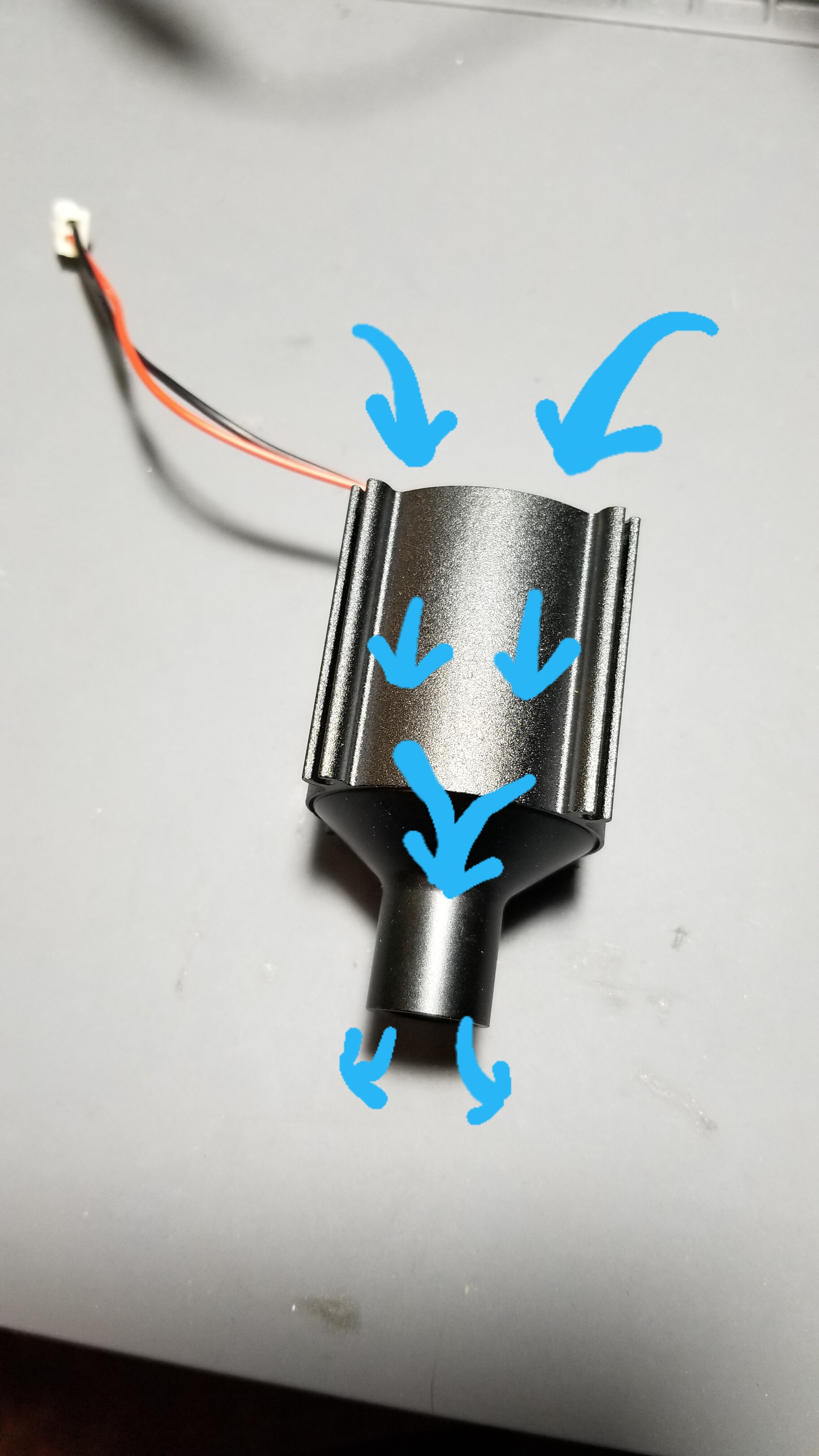

The shape of the heat sink is interesting. The fan sits on the top and the housing directs the air down past the inner heat sink fins and out of the housing where the laser outputs. Sort of a mild air assist you could call it. But the amount of air is likely only there to keep smoke from rising up into the housing and fouling the laser lens. Pretty clever.

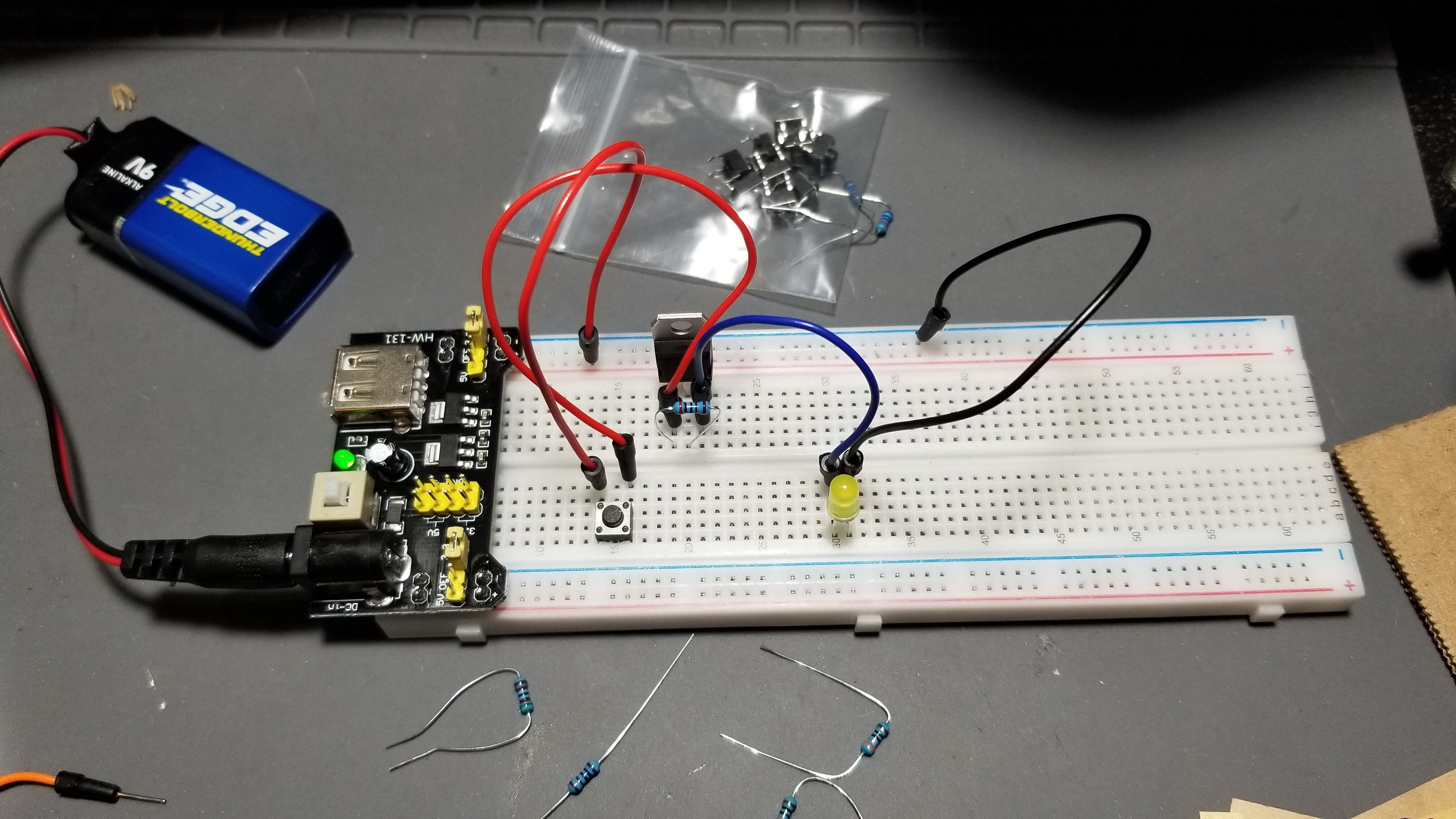

Here I set up my bread board to test my low power supply circuit. Why is is called a ā€œbread boardā€? Good question. I donā€™t know. But I digress. My bread board has a power supply, this takes 9v and drops it to either 5v or 3.3v. I have it set to 3.3v for now. I ran the power into a switch then L7805CV linear voltage regulator IC run by a 2k ohm resistor then through a diode then to the ground. This keeps voltage nice and stable. Is it necessary? Probably not, but it gives me a warm and fuzzy feeling.
Pushing on the button lights the led. The circuit is functional. Always test your circuitry BEFORE applying to what you want to power. Pop a cheap doo doo led, no problem. Risk popping the only item you are trying to test and not sure if or when you can get another? Bad ju ju.

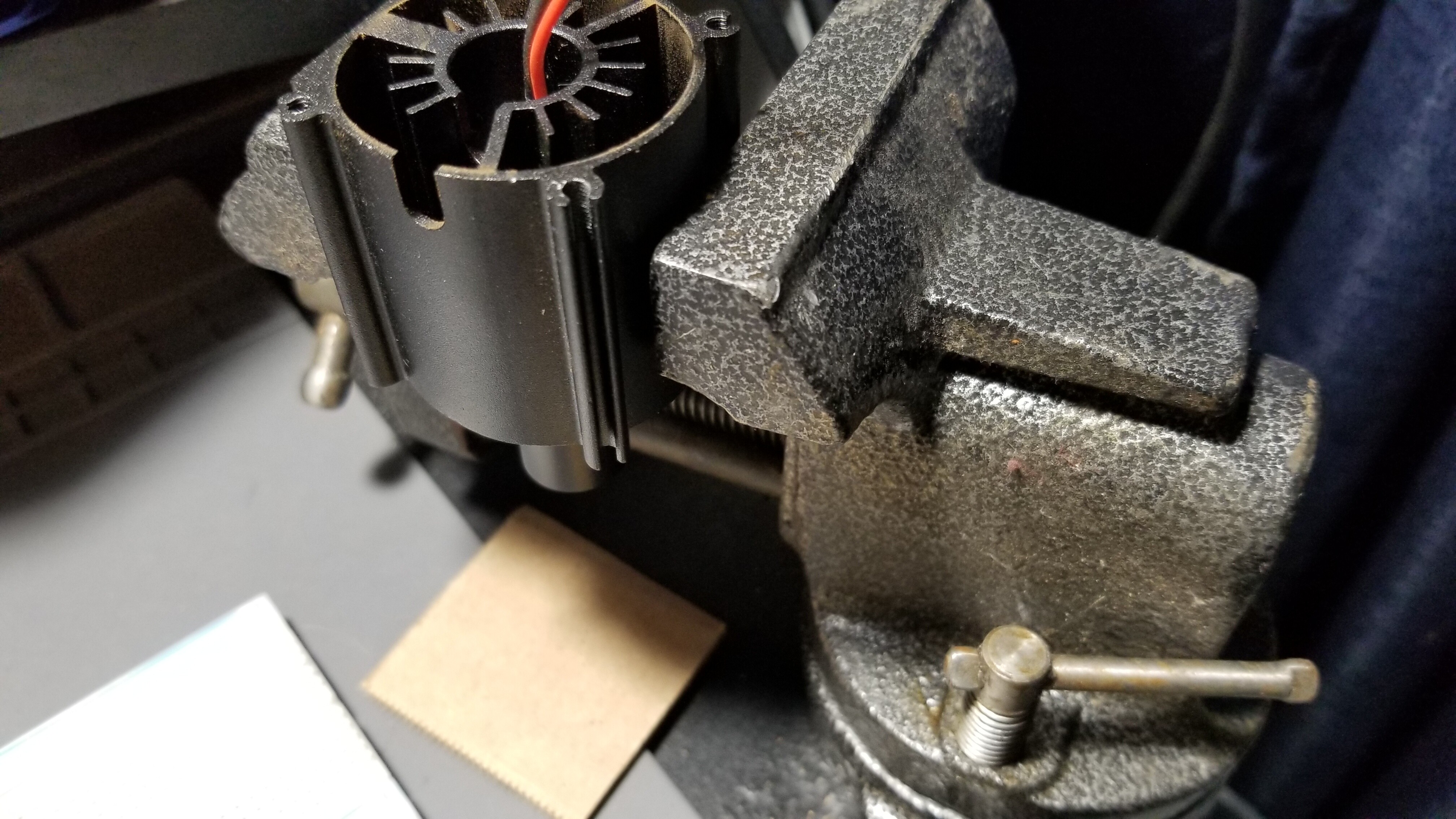

I mounted the laser in my freakishly small bench vise with the output facing down into my wooden table. Then placed a piece of cardboard under it. Now what? At this point Iā€™m pretty sure I know what you are thinking, ā€œNext we hook up the power and test it?ā€ Wrong! Now you put your safety glasses on.
I already know the punny 3.3v wonā€™t do much so I moved the jumper to 5v. This should probably provide an output of well under 200mAh. Just a guess, I could hook up my digital volt meter and test it but Iā€™m being lazyā€¦ :man_shrugging: The 9v battery has an output of around 490-500mAh, so this should be enough to at least make the laser illuminate.
OK. Safety glasses on? Check. Power to the bread board on? Check. Leads hooked to the laser? Check. Letā€™s do it.
How about thatā€¦ The led laser works. Not nearly enough power to burn anything, but it made a dot. A super weak laser pointer. But still, progress is progress. Now to inject more POWER! AAAH HAHAHA! cough, excuse meā€¦
