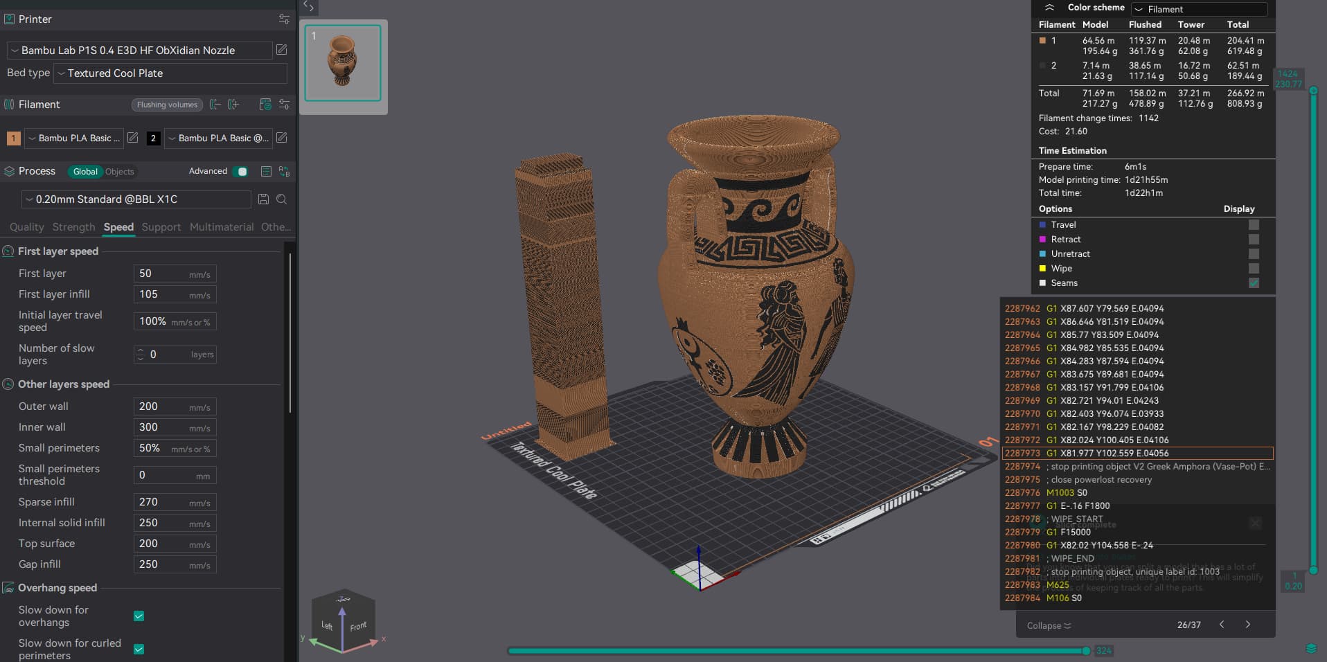

Here’s what I got with one 2-color Greek Amphora Vase (version with 150% scale, it’s a tall print):
  • U1: 13h17min, 29.82g tower
  • Bambu P1S with the E3D HF Nozzle: 1d21h55min, 478.89g flushed + 112.76g tower
  • Model: Greek Amphora
  • Model creator: Surreal Sonicus Studios
  • U1 Saving: approx. 32.6 hours and 570.21 grams of filament
  • In total, U1 takes only 29% of the time and uses only 30% as much filament (only 5% as much waste!)

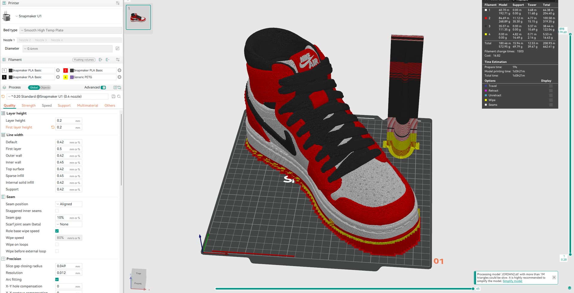

Nike Air Jordan shoe: https://makerworld.com/en/models/45917-nike-air-jordan-1-closed-mesh?from=recommend#profileId-165737
PLA with PETG inerface to allow easy removal from the build plate. i made no changes to the 3mf in Bambu and matched the settings in Orca
The A1 will take 2 days and 18 hours and use alomst 1.2KG of filament for a 542g print
The U1 will take 1day and 3 hours and use 662g of filament <3
Oh that is a beautiful example! :+1:
