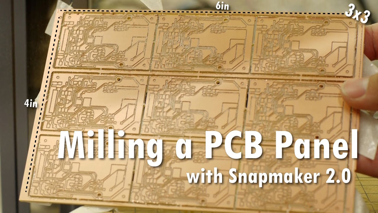

I use Eagle, Flatcam and finally Open Scam for Open Scam you need additionally a couple of dll if you don’t have them on your PC let me know and I will send you this via Email. I hope that we are able to succeed . I bought me a couple of extra fine drill bits, I let you know if I do progress
I had a lot of success with making pcbs with snapmaker 2.0. It takes some work getting the gerber set up to work on the snapmaker.
Here’s a video that walkthrough the process
Here’s a video on the snapmaker milling the pcb
Hi There! I’ve watched your videos and wanted to thank you for sharing the content!
I’ve picked up some titanium coated carbide bits 0.1mm @ 30°. Would you mind sharing your feeds and speeds?
your welcome! thanks for checking it out
I am using the default work speed of my snapmaker, which is 600mm/minute.
The jog speed setting is at 3000 mm/ minute
