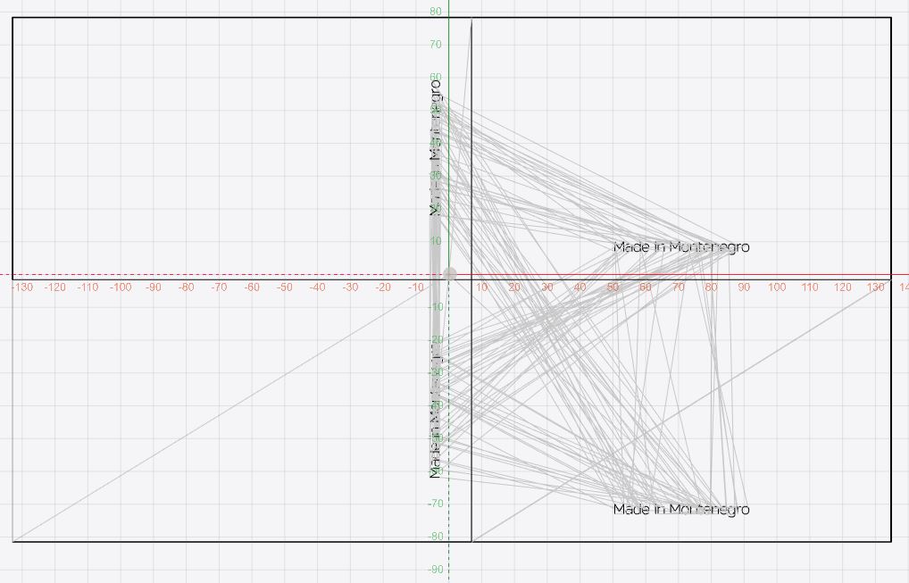

Is there a way to optimize path and travel time in LUBAN 4.0 ?
Attached is the image, when i have many small lines, and creating vector toolpath from them I end up with very bad G-Code. Jumping all across board. Lots of lost time in travel.
I think there was checkbox in earlier versions for optimizing path, or am I wrong?
Thanks
Lightburn does! But it costs money :frowning_face:
No.
Even with optimize path it was never great.
Have to use Lightburn for control over toolpaths.
Luban is very basic.
One thing you could do in Luban to improve is to set up the 4 items individually and then do them sequentially.
