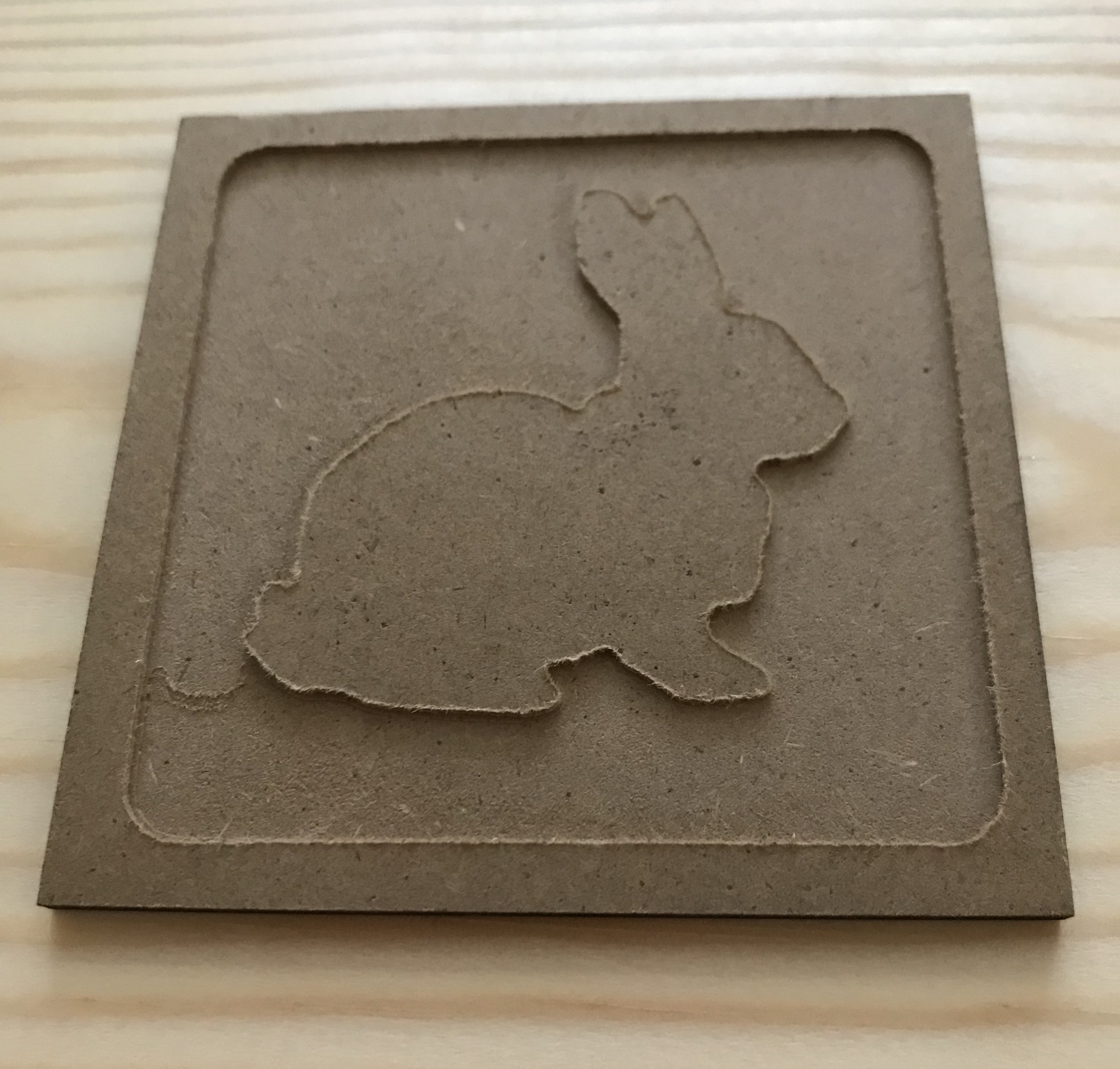

Managed to get some time to test today (been a bit busy with some other stuff - laser engraving etc).
Ran a simple test of an SVG outline - just recess around it.
Used a 2d adaptive clearing then a 2d contour - came out OK :slight_smile:
This was using just one tool.
Still wondering what the snapmaker will do if I switch tools from one process to the next within a setup (would like to know before I try). Does it move up and wait for you to change it? How does it know that it has changed?
Or do you need to have them as separate jobs?
