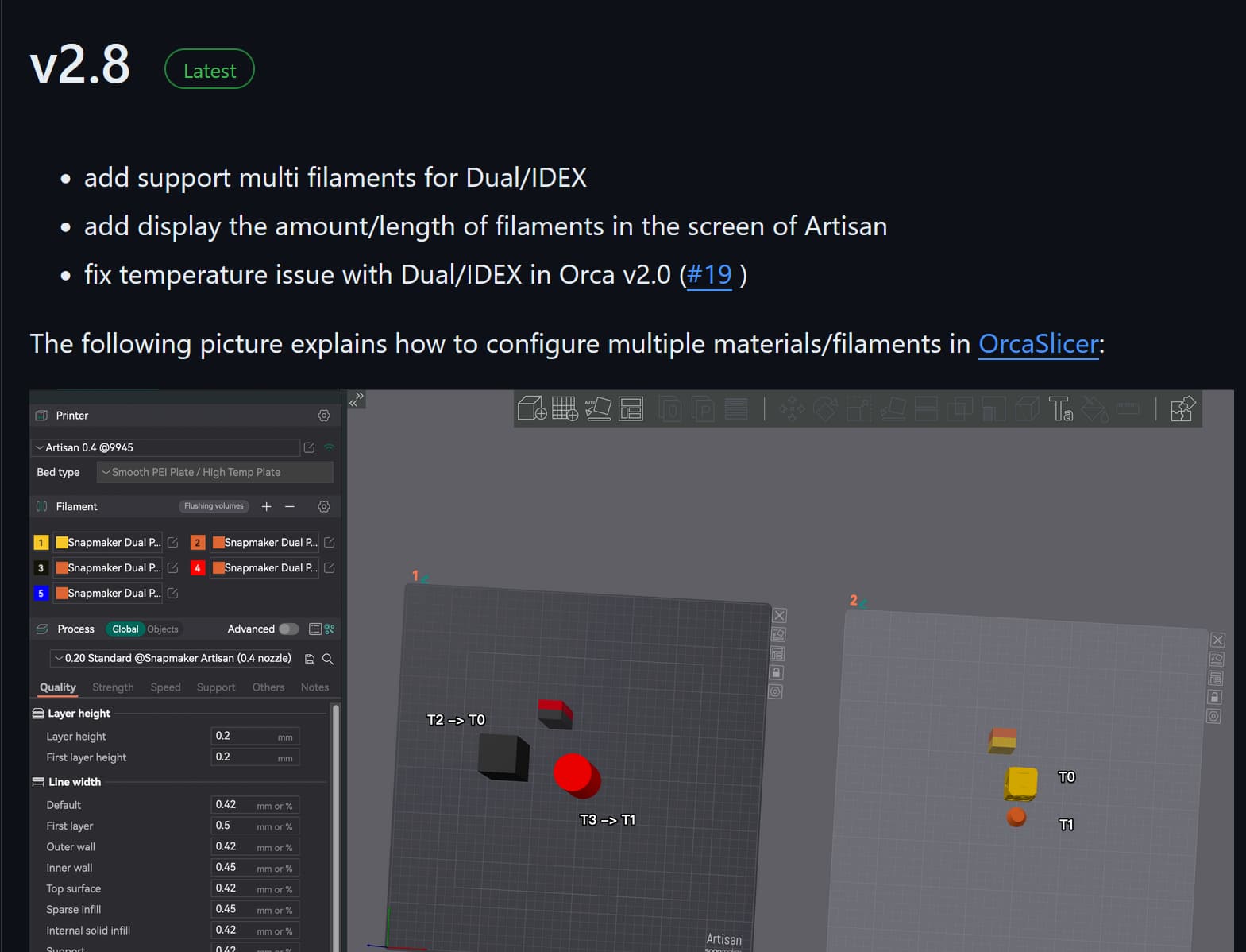

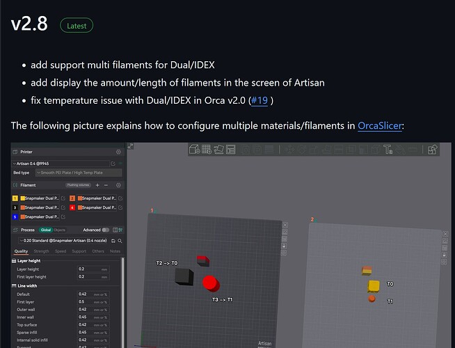

I had similar issue in the past while using sm2uploader v2.6 and OcraSlicer. The fix was to update sm2uploader to >=v2.7 (Releases · macdylan/sm2uploader · GitHub).
Thank you for this suggestion, I thought I was already on the most recent but I suppose not! This looks exactly like what I am having issues with. I’ll give this a shot the next time I am able to do so.

So far I seem to be having much better success with dual extrusion mode and not having clogs or any of the issues previously mentioned by updating sm2uploader to the newest version (2.8). Now I just have to do a full tune of the machine because the actual prints seem to be lower quality than what I remember it was capable of doing before.

Since v2, sm2uploader has integrated the features of SMFix, “A Snapmaker2 G-Code Post Processor for PrusaSlicer/SuperSlicer/OrcaSlicer to create compatible files for Snapmaker printers.” For example, how the tool switch is performed with regards to the standby temperature and when it should start to re-heat a paused hot-end. Version before 2.7 of sm2uploader was buggy in this regard.
To my understanding, sm2uploader is targeting OrcaSlicer or PrusaSlicer which do not natively handle IDEX machines. Therefore the need for modifying the g-code.
With Cura, I don’t think sm2uploader would be useful or even working at all.
