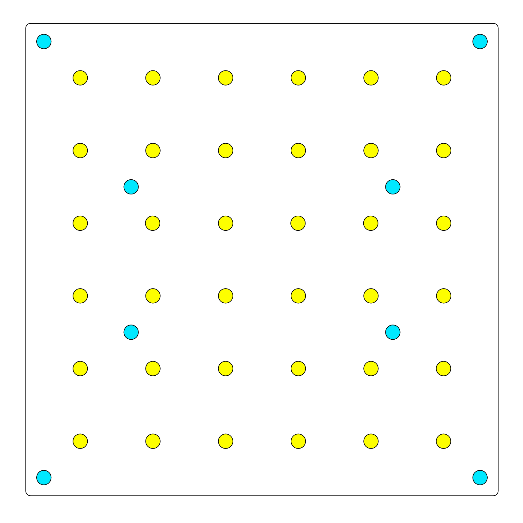

I want to make a particular pattern of holes in the new bed. Ideally, it would achieved by using Luban but I have a couple of issues. The CNC part of the application is not as clear to use as I would like. Having worked out where I want my 3.3mm holes (the size needed for an M4 tap) I set up a Luban drawing with 0.1mm points. I only need to mark the metal so I can drill it using my pillar drill and a cobalt drill. Then I would tap the holes by hand and use the cutting fluid shown earlier.
Luban permits me to make the points as 0.1mm but does not show them. A check using CAMotics shows that the points are not doing much in terms of creating a toolpath that would allow the Snapmaker machine to effectively centre punch my holes using a V carving bit. Have I found the limit of Luban or the Snapmaker machine?
The next illustration shows what I am trying to achieve.
The blue coloured hole positions are the corner fixing points of my jigs and the blue internal four hole positions reflect the limits of where the table will be attached to the ‘Y’ axis rail. The yellow hole positions are the ones on which I would like to use Snapmaker and a ‘V’ carving bit to mark their positions on the metal plate I have made and will use them to hold to the table to the ‘Y’ axis rail.
I need to understand what the effect of bit size will have on my hole positioning, where there is some method to ensure that I can specify a 0.1mm point and depth. I will be happy to keep posting until the project is complete. The clamping system will be a simple vertical circular pillar with a hole through it and a flat filed on one side so that there is a clamping lip of a few millimetres to hold the workpiece without impinging excessively on the ability to CNC machine it.

A little extra work done today. The pattern of dots you see in the illustration below was what I submitted to Luban.
The dots are 1mm in size and I had wanted to use a V shaped carving tool to place the dots on the new table. I had expected the tool to just descend for each dot until the depth of .5 mm was reached. I was trying to produce a point that the drill bit would treat as a centre punched mark when it came to drilling the table. The carver wanted to produce very tiny circles and although it did each one in one pass.
This was not the effect I was trying to achieve. I was trying to get the tool to just touch the table and descend .5mm without moving laterally. In the event, I used the marks made as a location point for my automatic centre punch. The centre punched point was exactly what was needed to locate the drill bit correctly when using the pillar drill.
