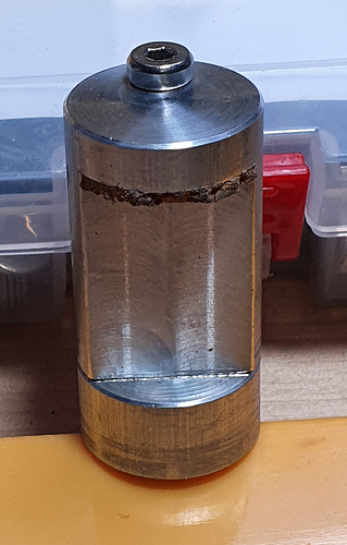

Edit: I forgot to include the 10mm spacer so to complete the project here are some additional pictures. The first image compares two clamp bodies (from the side) for length where one clamp has the additional 10mm spacer attached.
This image shows the circular spacer attached to the clamp from the front. It also shows the line scribed for me to file the flat on it.
The next image shows the spacer with the scribed line in a vice ready to file the flat.
The final image is the spacer after filing.
