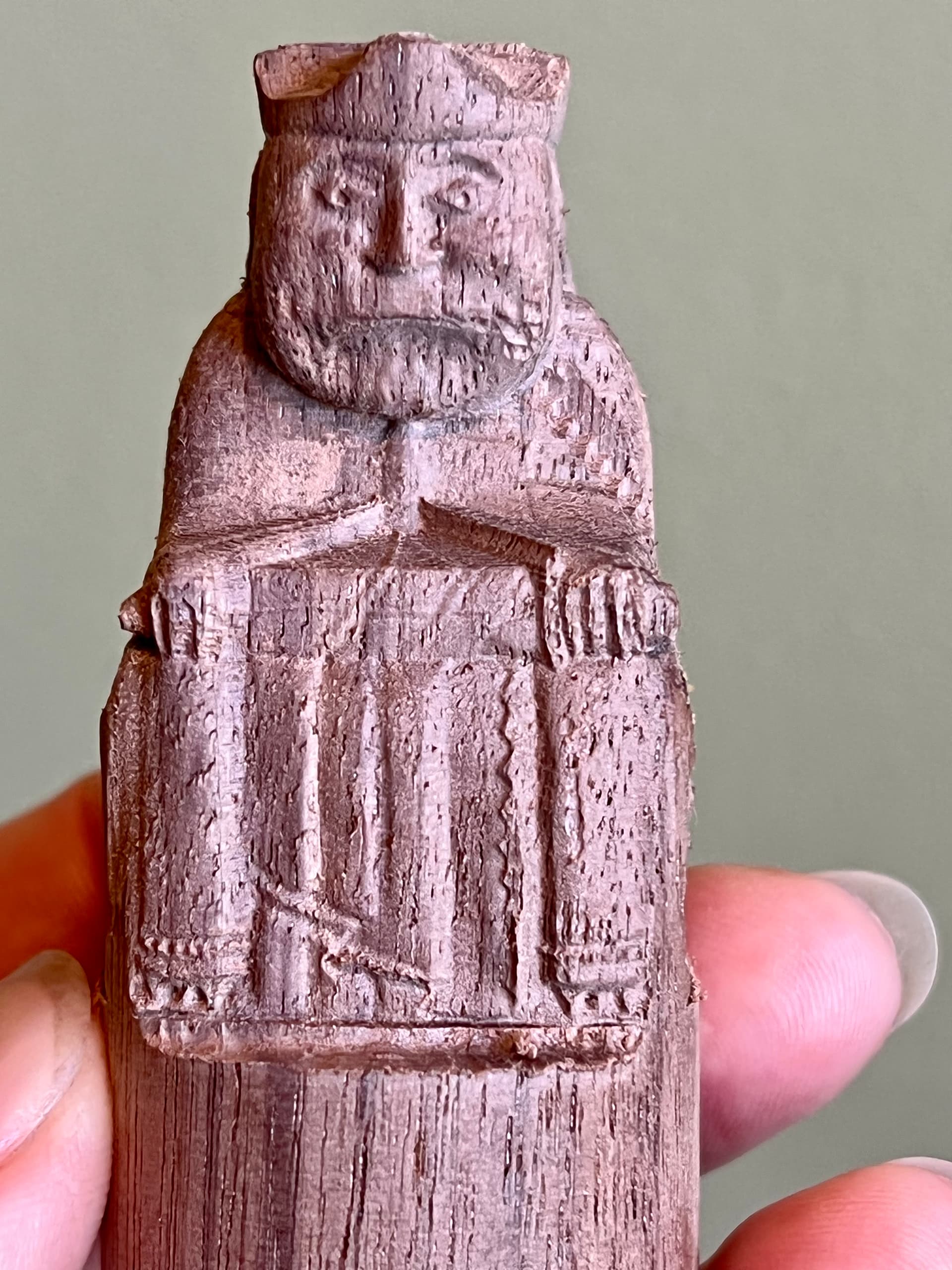

I have most things working now, see pictures below. A couple of minor issues and I’ll ask those with other pictures.
two things I have noticed: 1) there are the expected artifacts from using rotation vs. linkage (like the crown and any spaces/dips between parts; and 2) on the king there is what appears to be a reverse of his hair in back, engraved in the front. Any thoughts? Also he is a mirror image, which I suspect may be from reversing B and B-? The Queen is also a mirror image while the Rook is not, but I did not change B and B- for that one.
It crossed my mind that it might reverse, but I hadn’t experienced it. (I do admit I’ve not done any asymmetrical carves) I want to do more tests and prepare another tutorial for the CNC, but my job has me on double overtime and I have zero time. I was going to test if it mirrors, but haven’t gotten around to it. However, they look good otherwise! I encourage people to post their tests here so we can find things like this. If it’s important, it might be good to mirror the STL before generating. As I recall in my last test (for linkage mode) I DID note that linkage runs the proper direction, no B-/B reversal needed. Again, however, I would like to do more tests before absolutely confirming it. I need more of the straight groove v-bits, I still only have the one that came with the rotary and I’m afraid of breaking it, the replacements are expensive (after factoring in shipping, they do not offer them on their Amazon) and I haven’t found a good replacement 3rd party.

Any thoughts on why there is an “indent” that looks like it’s the hair from the back of the model? That one confuses me. I’m less concerned about the mirroring, as you said, I think I can fix it, and even if not, I’ll just have a bunch of left-handed chess pieces!
I’m not sure, since everything else seems fine. I wonder if it was just a Luban thing, kinda like how it decided to just eat through the side of the ring I posted earlier for no apparent reason.
For mirroring, that’s easy if you have Prusaslicer (I actually use it a lot for STL editing, but it’s also my main slicer for 3d printing as well) Just open the model, right click > mirror, choose which axis to mirror it on > right click > export as STL. boop, mirrored.
If I can find the time this weekend, I’ll do some more tests. However! I did do a test I could do straight in Luban. I grabbed an asymmetrical STL, ran it through 4-axis with the v-bit to get a nice outline toolpath, did the B/B- swap, and stuffed it back into Luban to get the preview… It mirrors! Good find.
Note to anyone who uses the G-Code optimization; MIRROR THE STL FIRST, changing rotation direction mirrors the object along the B axis.
For those who use Linkage mode; B/B- change might not be required, but if you do it on the roughing pass in rotation DO IT ON THE LINKAGE FINISH AS WELL, since it mirrors the model.
