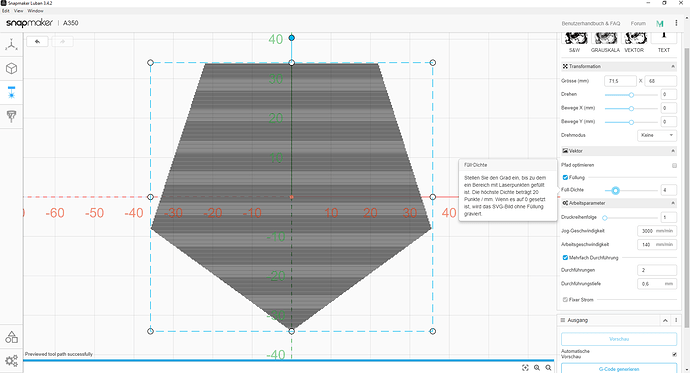

Danke, kannst Du mir ein Screenshot senden, damit ich sehe, wo ich das einstellen muss? info@robertschmid.ch
Sorry.
Wo ich das einstellen kann.
Rechts bei den Einstellungen zu Vector kann man die Füllung aktivieren und den Füllgrad bestimmen
Herzlichen Dank.
Gerade habe ich gesehen, dass ich erst die Version 2.7.1 installiert habe, dort hat das nämlich nicht richtig funktioniert. Mit der Version 3.4.2 funktioniert es gut.
Herzliche Grüsse
Robert

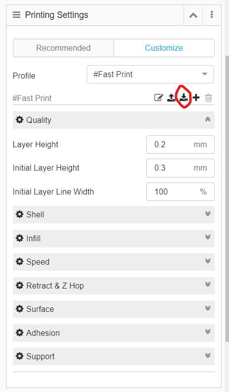

I would like to see the Snapmaker team implement the persistence of settings in Luban software. It could possibly be achieved either by a keep settings button or by just keeping the settings used previously until they are specifically changed deliberately. It would make processing a batch of similar situations far more efficient rather than having to enter the settings for every iteration of a similar process. Thank you!
You can already save your custom profile in Luban 3.5.0. The settings are just buried under Customize.
Once you save your custom profile, you can upload it next time you run Luban and you will get back your settings.
We are working on addressing some known bugs in Luban 3.5.0. The bugs only affect the interface not the actual use.
I remembered that I did not finish this conversation with you JKC20. My apologies. The persistence of settings issue remains for me when using both CNC and Laser etching. I believe that it is correct to say that the settings which are saved with the customised printer profile you have illustrated, are only available for 3D printing. Unless I have missed it, there does not appear to be any place to customise the profile in either the CNC or the laser segments of Luban.
