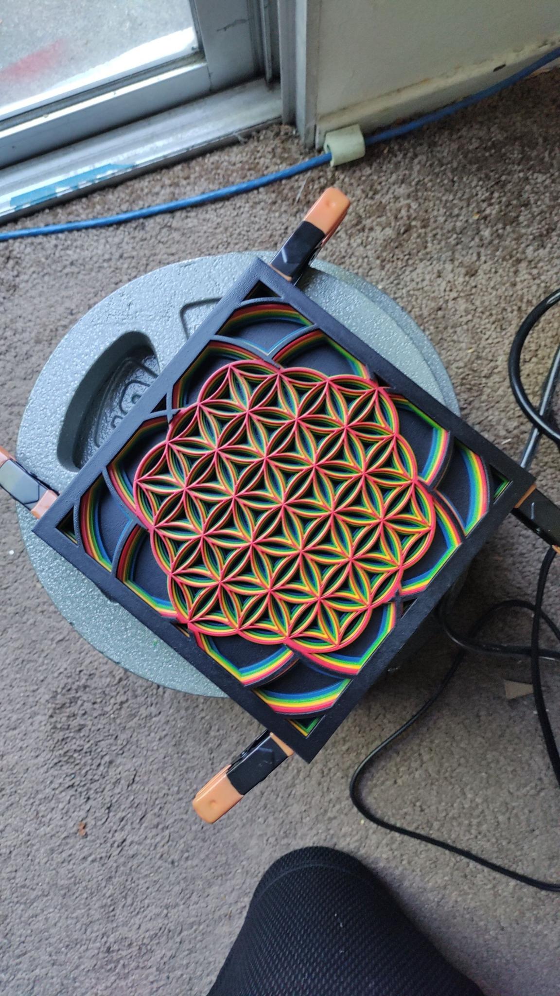

Laser Cut Art with the Snapmaker V2 A350 10watt Laser
MDF Board 1.5mm or 3mm
Wood 3mm - 6mm
Lightburn
4-10 passes at .1mm In at 900mm/min at 85% (still tweaking settings)
Almost all wood has been warped so multiple passes helps and using a weight on the material as well.
I need to make small holes in the corners for alignment purposes.
And I would love to integrate LEDs when I get some brain power.
really nice like it so much from where you got those or prepare by yourself?
I’m making the files in Illustrator. Here’s an example. I can’t share an AI file.
Here’s how I created the layers. I add or subtract “offset path” and use the “sacred geometry” and other values of 5, 10,45,120 degree rotations, etc.
Another I made today for my cousin
With my “enclosure” :smiley:

I’m finding that the 900mm a minute with 75-80% power at 0.1 IN and depending on thickness 2-20 passes is just what I started with.
This is what has worked so far for MDF:
900mm/min
1mm 2 passes 0.1 in
3mm ~6 passes 0.1 in
5mm ~ 15+ passes 0.1 in
This is my go to for cutting 3mm MDF

Does it char badly on the 5mm? Have you tried deeper z-steps? Really like the final three images (last two of project + enclosure)!
Also forgive my ignorance, what are the values for the “sacred geometry”, do you mean like the golden ratio in snail shells? Any help on this would be appreciated :slight_smile:
If you’re worried about a bit of the char just sand it, but if you’re painting, psh. Don’t worry about it that much.
Deeper Z-steps… no, not really. I think I tried .11 or .125 but I’m kind of sticking to what works regardless of passes.
“sacred geometry” Sacred geometry - Wikipedia
