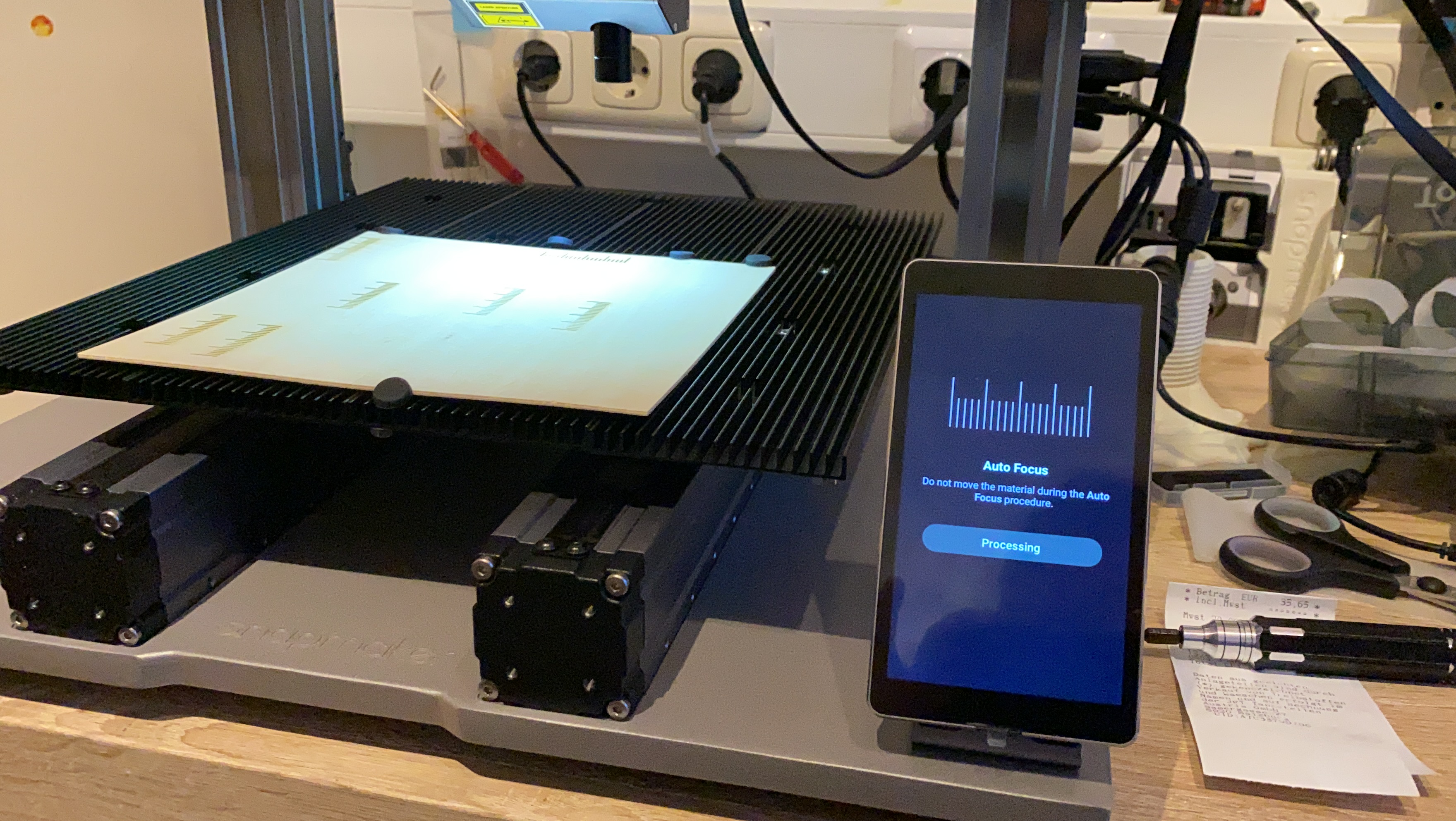

I received my Snapmaker last week.
Now I tried to work with the laser module but when starting the autofocus process, it gets stuck in edit mode when the camera is supposed to read the burned-in lines.
The auto calibration process cannot be skipped or canceled.
When restarting the machine, the calibration process starts from the beginning.
Also it is not possible to leave the calibration screen to get to the main menu of the machine.
Furthermore, even when connected via Luban, the capture with the camera does not work.
No picture is taken although the laser and the camera are displayed as a green dot in the touch display.
I have installed latest Luban 3.12.3 and use latest Snapmaker2_V1.10.1 Firmware but earlier firmware versions do not work either.
Thanks in advance if someone has a clue how to get the thing working.

Laser works and is drawing the lines but straight after drawing the lines it hangs in the loop of processing(autofocus adjustment).
Only an off/on restart is possible.
Even the manual laser adjustment menu is not accessible, because it’s not possible to skip the initial laser calibration. :man_shrugging::sob:

Doing laser autofocus. Laser draws calibration lines, then the head backs up and lights the work surface. The procedure freezes at the “Auto focus/Processing” screen and never advances.
I have an enclosure, but it is unplugged from the controller as I found that having the door open stopped the laser. The laser works but it still sticks at the “Processing” screen.

Thanks for your comments. After consulting the support, the module was replaced by Snapmaker.
It looks like the built-in Bluetooth module in the laser module was defective and therefore could not transfer images from the camera.
The replaced one works perfekt.

The more I work with this, the more I believe that the camera is not working, even though the initial screen shows the camera as green. When I connect to the machine with Luban, the “Camera Capture” button does not display a picture. It does nothing, really.
There is one method to jump the guide instruction.
  1. power off the machine, and unplug the laser module.
  2. power on the machine and follow the video1.
  • Tap the image on the touchscreen 5 times to enable the developer mode
  • Reset the user reference
  1. after you finish the steps of video1, please power off the machine.
  2. connect the laser module and power on the machine.
  3. follow video 2 and can you tell me the camera light is yellow or green?
  • Tap the image once to exit the developer mode
  • Test the Bluetooth function, and I am sorry for the Chinese characters. Please do as video 2 to test the Bluetooth function.
