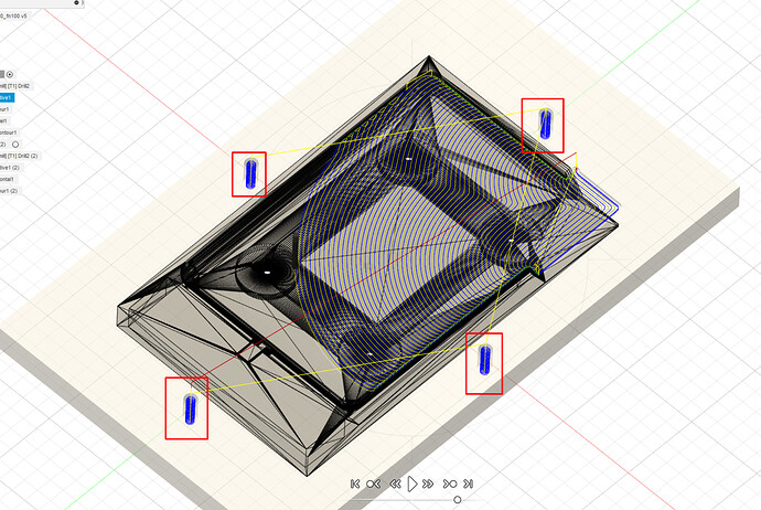

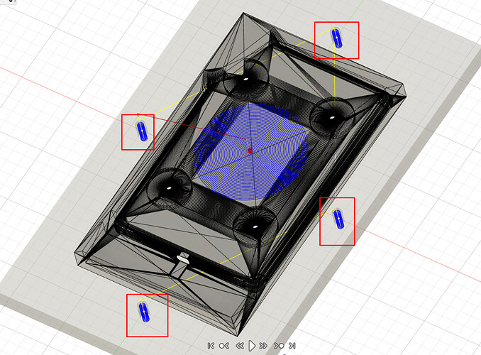

I’ve done some 2 sided milling as well and, when possible I like to use the dowel method for flipping the piece around (assuming your stock is large enough:
top side:
bottom side
Basically, you make 4 holes around it and drill these into your workpiece and in a sacrificial plate below as well. Most convenient is if you place them around the rotational axis of your workpiece.
Then create a toolpath for just the dowel holes and run that on your piece of stock (all the way through) and your sacrificial plate. (and obviously you only cut them once in your stock)
The nice thing about this approach is that it doesn’t really matter if the outer dimensions of your stock aren’t perfect and you only have to define your origin once.
Using dowels (I use metal ones) you can fixate the stock and make sure it is aligned perfectly. I usually clamp it in place as well, but the dowels make sure it’s aligned almost perfectly. The mill one side, flip it around (make sure you flip it the right way! :)) and do the other side.
Works pretty well!
