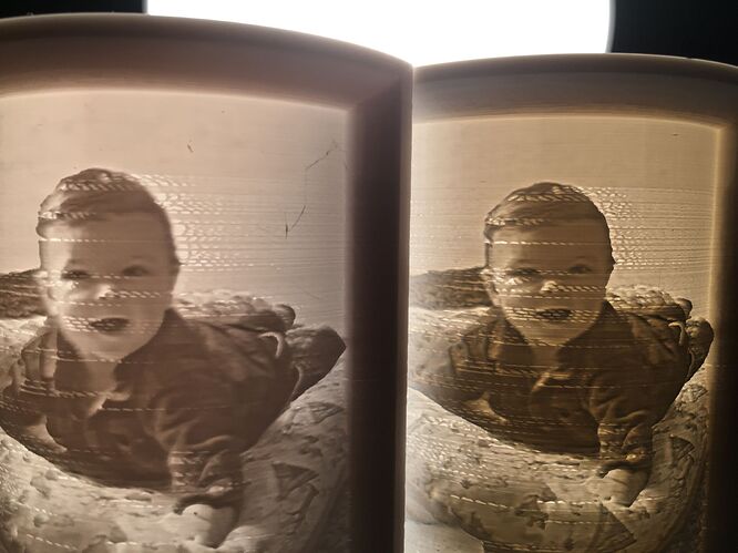

Hi there. I printed some Lithophanes recently and discovered some issues in the print. After reading, that it could be the Filament (SM white), that might be not the best, i ordered new Filament from a different brand (geetech) and i printed the same Lithophane again. And there the issues/gaps appeared at the same spot like before.
I used the Lithohanemaker.com website and the normal Lubansettings. But for me i just wondering, why the issues appears always at the same spots? Rest of the print is ok, also the bed leveling is pretty good.

I would say this may a layer width issue. Printing very thin or small feature on Snapmaker machine may be a challenge.
You can increase the wall thickness value in Snapmaker Luban Profiles.
As the layer is very thin, you need to slow the infill speed to 30mm/s to 50mm/s.

In my opinion that looks like an artifact relating to linear advance. Before a print starts you could try issuing a M900 K0.07 from the terminal to temporarily change the linear advance setting to something that works for many people.
If that works, M500 to save to memory.

M503 will report the saved M900 value from EEPROM, which will be K0.22 if you haven’t changed it. In my opinion that is way too high for a short direct drive extruder like the Snapmaker has.
This really is only a plausible explanation if this area is at the end of the line, not the start:
A linear advance K factor that is too high will result if pushing extra filament out at the start of a line, and then retracting at the end, leading to drastic under-extrusion as the head decelerates.
Linear advance is designed to pressure-compensate for the springy-ness of filament in the extruder drive system, but setting it wrong has bad effects. 0.22, like comes from the factory, may be more appropriate for a short Bowden tube style extruder. 0.22 is actually the Marlin default, and has not been changed by the developers.
It’s a mystery to me why some people have issues related to this, and others don’t - could be the speed at which people choose to print - slower speeds will not exhibit the negative effects of linear advance as much as the acceleration is much smaller.

I tried a new print with and changed the linear advance setting to K0.07. But it is the same result, the same artifacts at the same spot. :frowning:
I have no clue or technical understanding what is physically happening there - i cant imagine why always at the same spot - even if i turn the print 180° and set it on a different position on the bed.

Thanks for PMing me the gcode. Here’s my analysis, with follow along steps as requested.
First, load into gcode into ncviewer and orient the image, adding G21 and removing the header so it renders properly.
You have issues here:
Looks a lot like the gcode here:
Now why would that be?
Zoom in and play back that section line by line
There is a front wall, a rear wall, and then a bunch of tiny little segments inside the wall because the wall is too narrow to fill with a continuous string of filament.
So the gcode is commanding the machine to lay down intermittent short segments as fill. This is a terrible strategy and will fail easily, due to stringing or poor adhesion.
Your print temp is only 197, which unless you’ve optimized already seems too low.
My theory is the filament is not adhering properly to the below layer, and being pulled up into a ball by the internal shear forces.
However, this is a very thin wall, so if you raise the temp too much it will sag if there’s not enough cooling, something the original head design struggles with.
Printing this successfully may be out of the realm of this machine without additional cooling, or tweaking.
I don’t think Luban (Cura, under the hood) is slicing this intelligently. Simplify3D (and I believe PursaSlicer also) has a variable width extrusion to fill thin gaps that would be ideal here. The interrupted extrusion is not likely to work here unless you fine tune everything such that there is no over or underextrusion at all, and it has to be perfect because it’s at the top of the model.
Another option to try would be to increase or decrease the thickness of the model wall, or the extrusion width in the slicer, so that the slicer does not generate interrupted segments.
You’ll need to carefully preview in Cura or S3D, as the preview in Luban is not useful for this level of detailed troubleshooting. After the previews look good, then I would do a special slice where only that problematic section is printed, to save filament. Once a proof print of that section works, only then I would again try the whole print.
Again, this is a challenging print for this printer. You may want to revisit the whole slew of calibrations at Teaching Tech, and recalibrate e steps and flow at the minimum, otherwise it will be very difficult to get this to print correctly. A temp tower might also be a good idea if you haven’t already done so.
