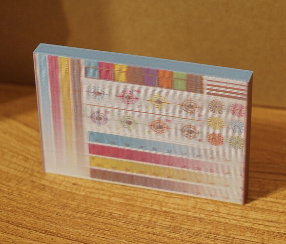

Recently in my OrcaSlicer fork (OrcaSlicer-ImageMap), I’ve implemented the ability to modulate filament overhang amount based on the model texture, in order to create patterns and images on the surface of 3d prints (the technique is based on a 2018 research paper by Kuipers, et. al, which I’ve been extending to full color surface printing).
Essentially when extruded filament hangs over the edge slightly, it sags and blocks some of the filament below it, allowing the creation of arbitrary colors on the surface.
Here’s a test print, the one on the right is a test with CMYK layers at 0.12mm layer height (the left one is just CMY):
And here’s a 2-inch-tall color calibration test sheet I printed with CMYW filaments (color calibration test image designed by freepik)
With this technique each layer only uses a single filament color, looping through CMYK (or CMY/CMYW) regardless of what colors are on the surface or how many different models are being printed at once. It also won’t have additional seams compared to single color printing (since the outer perimeter is continuous - the outer wall is just modulated to vary the overhang).
I haven’t tweaked all the parameters yet to get perfect results, but I think this technique could have potential

It’s been experimented with, but that can’t achieve as high a resolution or control of colour application as keeping the components in separate nozzles. There will always be a latency between the mix point and the deposition, but worse the components don’t blend – they remain separate within the extruded filament. The colour visible at the surface ends up being dependent on the orientation of the surface.

Is the perceived colour variable with viewing angle?
On the prints with 0.12mm layer height the colors get slightly brighter if viewed from a steep angle (from above or below), but on these 0.08mm prints I don’t really see any variation.
EDIT: actually looking again now, there is a subtle effect on certain colors with the 0.08mm prints, but it is way more obvious on the 0.12mm ones (you can see it over the whole print)
