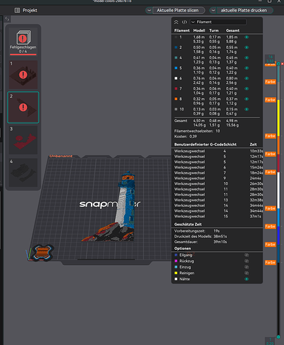

I have the same challenge here and find the idea really great.
Currently, unfortunately, you can only assign the 4 loaded colors at the start - unfortunately.
Of course, there is still the option of working with pauses instead of the 8 colors, but then you have to unload/load not just 4 times, but 8 times. That might still be feasible for a 37-minute print.
It would be nice if not only a color change could be inserted, but also a pause at the same time - of course, the prerequisite would be that more than 4 colors can be assigned at the start of the print.
If I understand correctly, SnapOrca’s slicing already supports most of the features you mentioned:
  1. Using more than four color settings, mapped to four physical channels
  2. Manually inserting pauses in the slice interface; it’s not fully automatic, but it’s not complicated either
  3. Pausing during actual printing to wait for manual filament changes
The only feature I think could still be optimized is supporting the definition of filament change commands, automatically ejecting the filament during the pause. In cases where multiple filament changes are required, this would improve efficiency.
Yes, theoretically, I can create many different colors using mixed colors.
However, this doesn’t help with a flat object, such as the example from earlier.
So, SnOrca can currently only add either color changes or pauses on the same layer—not both at the same time, which would be helpful.
