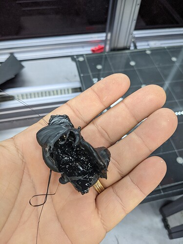

I will say in my favor that I’m playing in hard mode: ABS and PETG with some 10"+ square huge surface area flat prints that require excellent adhesion and no warping. Haven’t even loaded up PLA. Results have not been great, and I’m about to do my second “stuck so bad I have to remove the head and pull out the heat gun” cleaning job. Replacing the sock again. I might need new fan cowling, it’s not a happy morning. (Yes, this post is procrastination.)

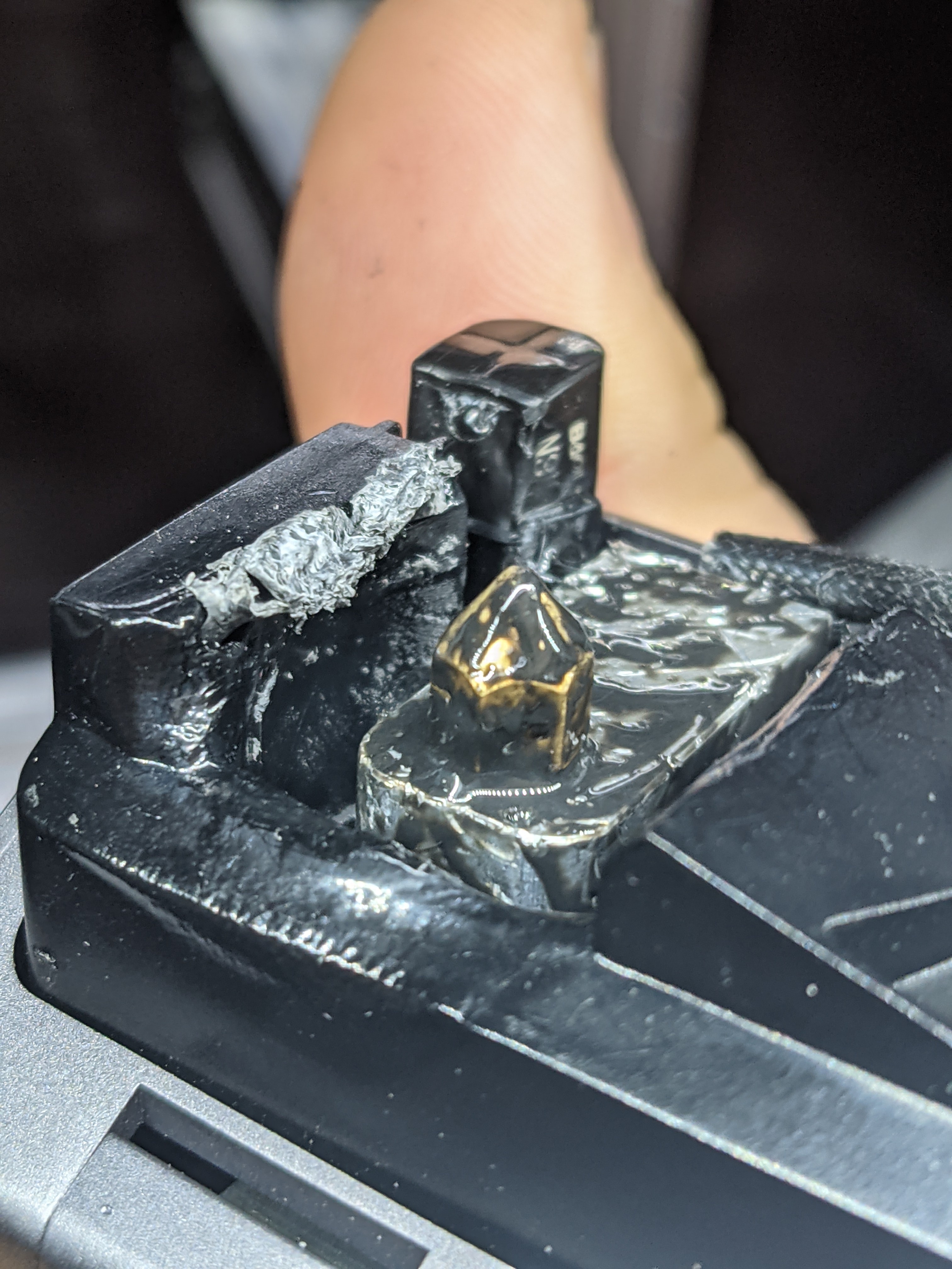

Not sure if you can tell how concave the duct is in this picture. Pretty sure I’m going to need a replacement part. :sob:
Here’s how much filament I removed between the hot block and the housing. I had to do this plugged in hot in order to be able to get to and remove the hot end.

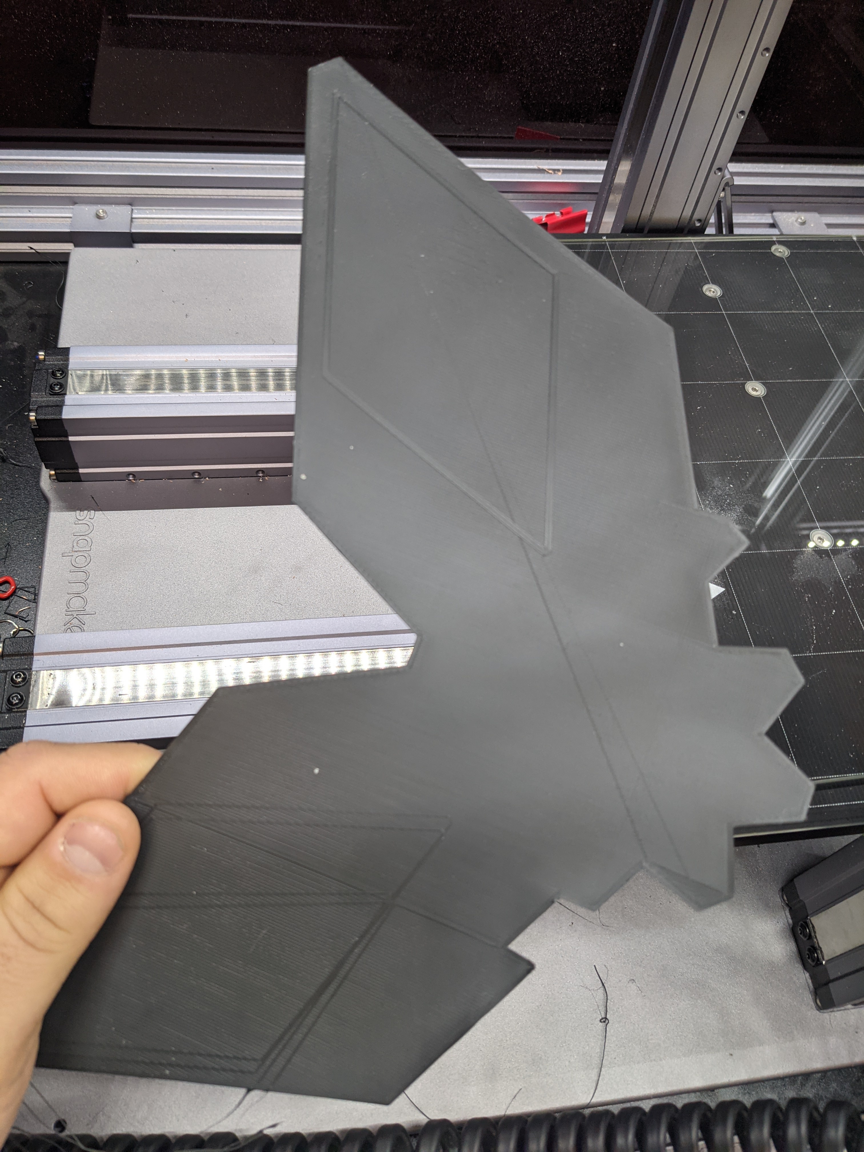

It looked perfect for hours
For starters, it seems that some (many) hot end assemblies were put together incorrectly, causing the nozzle to bottom out on the aluminum block instead of the heat break
This is causing a leak that the material might over time ooze its way out of as it builds pressure.
which is something that is stupid but at least can be addressed by adjustment
