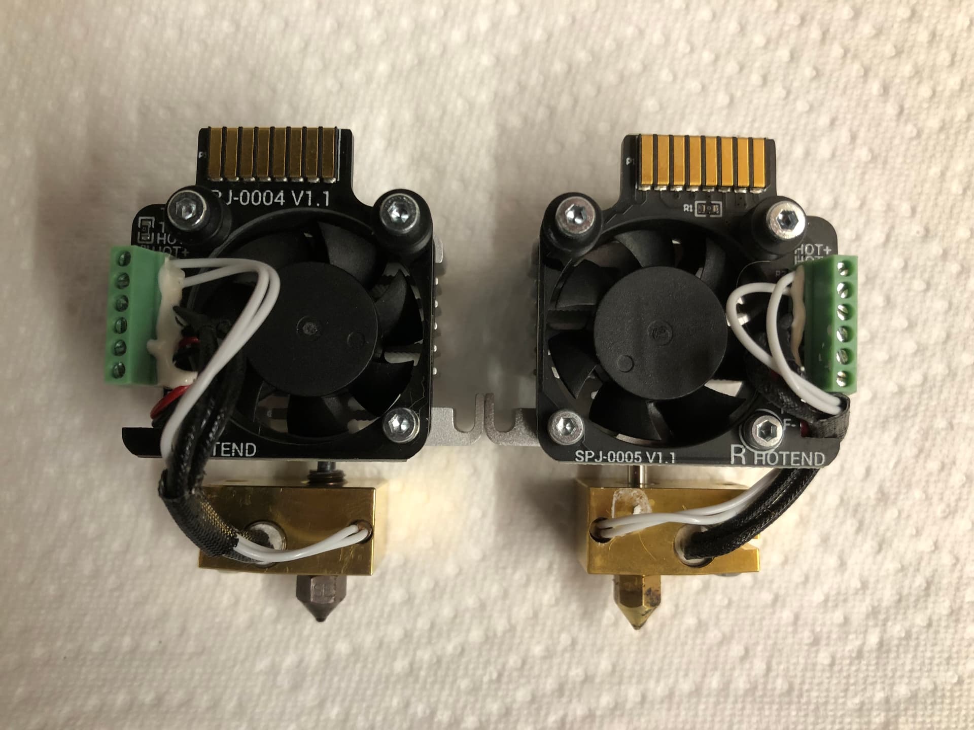

The different parts of the hotend in the assembly order.
Used pliers and a file to adjust the length of the adapter part. Make sure you don’t remove the side where the Allen key fits.
Ended up with 6.39mm. 6mm should do as well.
The assembled hotend. On the left the upgraded one and on the right the original one.
Btw, I’ve upgraded both left and right hotends now and everything has been printing smoothly including PLA, PETG, ASA, PETG-Carbon, and Filaflex 60A.
I’m very happy with this setup. Only the noisy fans get me crazy after some time near the printer.

You need to purchase the following items for one hotend:
  • 1x Volcano Adapter V2 from CNC Kitchen (I would suggest you take some more in case the shortening of the adapter is not right first time)
  • 1x Coperhead heatbreak from Slice Engineering
  • 1x GammaMaster AP3X from Slice Engineering (I went for the 0.4mm but you can buy the size you need)
  • 1x Thermal past (usually one pack of thermal past can be used for several heatbreaks)
Refer to this post from 3DPrintMunich for additional information and a discount code on the Volcano adapter.
