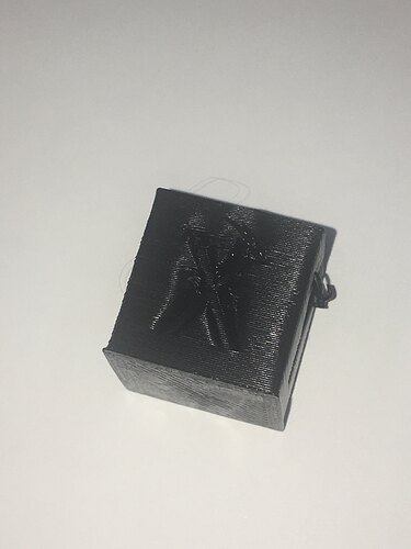

Sadly, After printing a calibration cube I’m still seeing issues on the edges of the letters, the corners, and still see some Z offset issues. I have searched everywhere for somewhere that shows what settings might cause individual issues with the cubes. Anyone know of any?
Issues noted:
“X” side shows issues in the center of the X on each side “melted” look
“Y” side - Right side of Y - Edge top looks melted.
Edge between two blanks are rounded and not sharp
I’m starting to get very frustrated with the machine.

here are a few shots of the cube - printed with direct G-Code through Luban upload via Wifi.
Z - Face looks fairly decent
Blanks are good except for corners are very rounded and one junction is melty
X and Y have droops at the tops and center of the letter edges and some external stringing even.
Bottom is still showing impacting of the bottom layer - I have tuned the Z-offset so many times at this point my head spins and it continues to do that.
(upload://8mq6vqgJXvzIJBgoblUaodKRu2r.jpeg)
Printed with Black PLA from snapmaker that comes with the printer.
Thanks in advance for any suggestions.
Throw away the filament and get some matterhackers or at least some hatchbox. that stuff is just trash.
try to start learning how to use Cura after that if you dont already. if you do, try the slicer flow rate calibration i linked above too

you know what man
i fucked up
that shit was in the gcode
i didnt turn supports off.
wana try again?
xyzCalibration_cube.gcode (454.2 KB)
Sure, I will give it a go, I am just having issues now as I printed a temperature tower and it stopped printing half way on the 180 tier. I unloaded the filament to try the ovation purple PLA I have and the extruder is scoring the PLA and not pushing it through. I can manually push it through but it just balloons out to the side and in very small volume. So I’m guessing the nozzle is clogged now thanks to the garbage heat levels of the snapmaker filament. Once I can get the needle to clean it or swap to the provided “backup” hot end, I will try loading the new filament once I get it.
