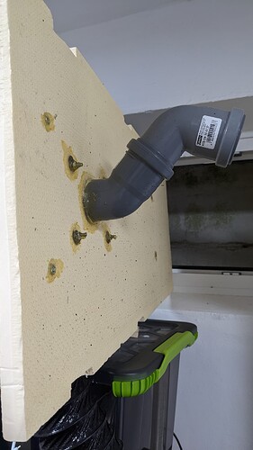

Is there a solution to get e better exhaust? The hose should be over 4meter. this is for the existing fan too long. Is there someone who has an idea to solve this? During laser cutting of wood, the vapour stays in the enclosure. It smells too much.

Also remember that the air you evacuate has to come FROM somewhere. If the enclosure is too tight, all the fan can do is create a bit of negative pressure. If you have an inlet on the opposite side of your laser than your outlet, room air can come in, grab some smoke, then get blown out the window.

I went with the cloudnine (AC Infinity CLOUDLINE S4, Quiet 4ā€ Inline Duct Fan with Speed Controller, EC Motor - Ventilation Exhaust Fan https://a.co/d/dksrLoW) and at full power it’s barely louder than the machine (I have the old noisy rails but it’s in an enclosure that does a decent job of dampening the sound). You can also turn it down to half power, but I find that at full power it sucks up all the smoke, and it’s in my garage so I don’t particularly mind the noise (the original PSU was considerably louder than the cloudnine).
Thanks this looks like a perfect solution. I ordered this fan and started building the piping under my desk.
I will send some pictures when it is working. :wink:
