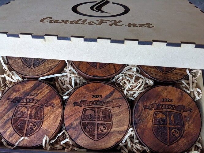

Quick update from our order we fulfilled over the weekend:
