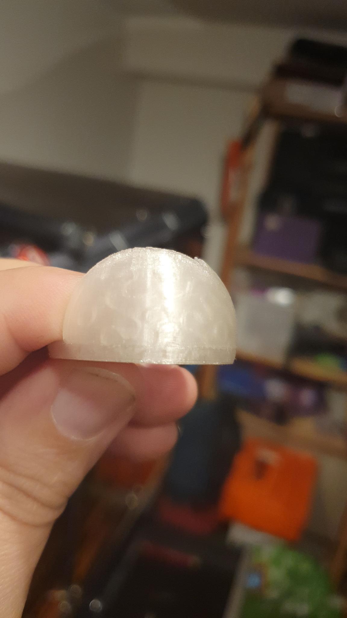

I was finally able to do it. I connected it with Octoprint and then set the feed rate to 10% via the UI. Then I triggered the feeding via the UI as well. Printing TPU is pretty much hit or miss at the recommended temperature of 230°. Half the time the filament is mangled up in the extruder at some point during print:
I was printing really slow with 10mm/sec and no retractions. I tried a few iterations with raising temperature and was finally able to get prints consistently printed without filament being mangled in the extruder at 250°.
While this is workable the resulting prints don’t look very nice compared to stuff printed at 230°. Here is a print at 230°:

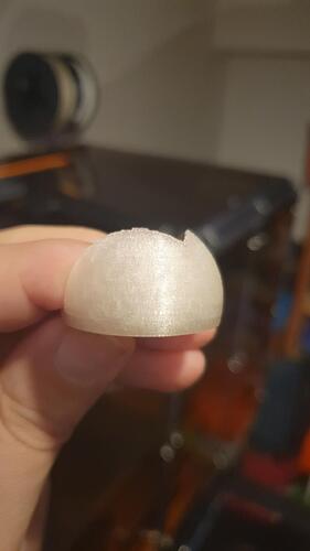

Here is the same print at 250°:
Note the much duller finish. At this point I’m really out of ideas on what to do, I love the 230° results but there is only a 1 in 5 chance of getting a print through without mangling the filament in the extruder. The 250° degree prints work every time but look really a lot ā€œovercookedā€.
