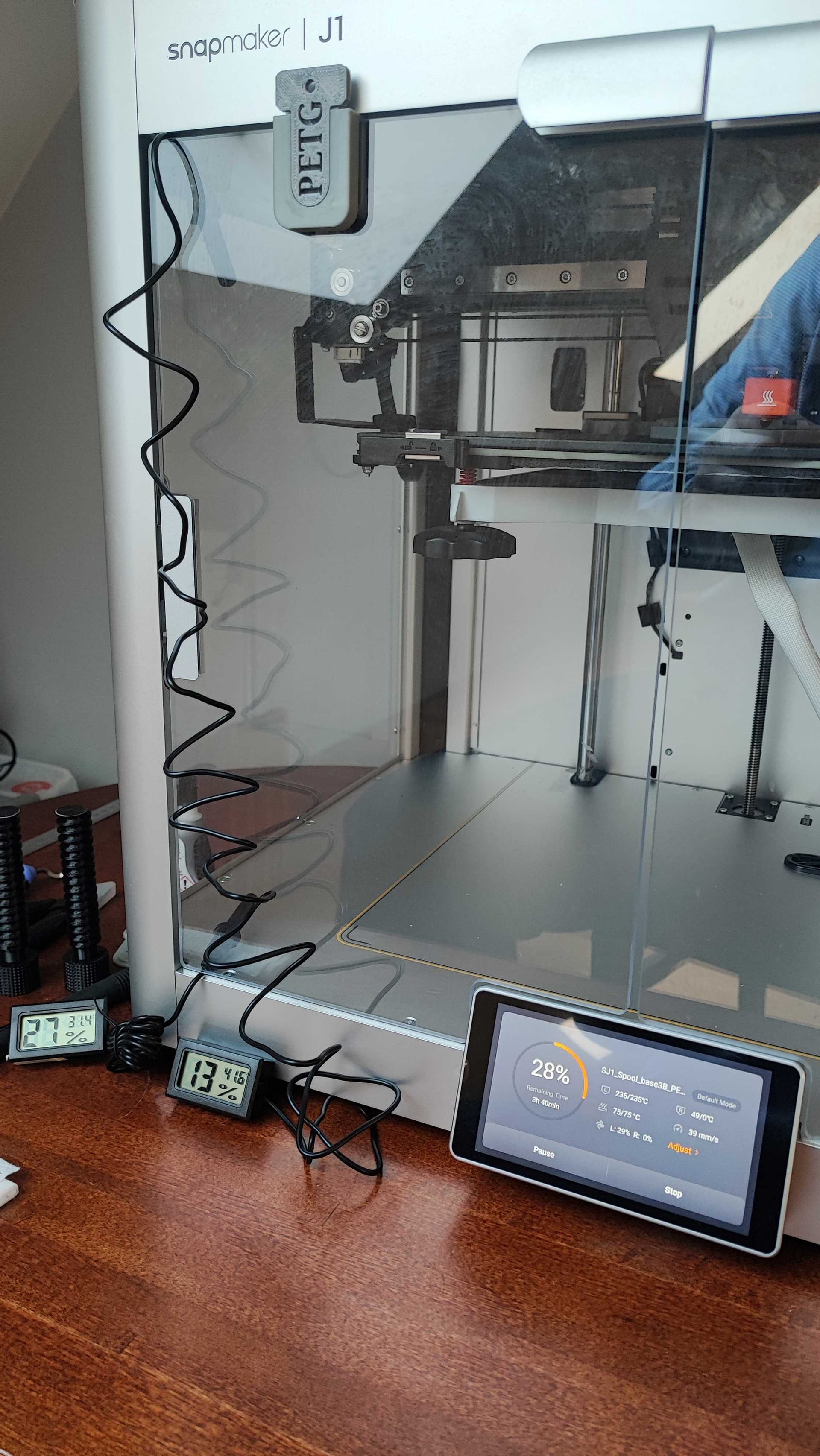

I have one thermometer fixed at the top left corner of the door, around 50 mm away from printing bed at the top position. Second thermometer is laying at the bottom left corner of chamber 50 mm away from print bed at the lowest (home) position. So, I have two temperature reading all the time. I can compare the readings at different parts of the chamber, lower and upper part, and compare with extruder reading, if printing with only one extruder at the time. I would say extruder reading is quite accurate, difference is up to 5 degrees only, showing larger temperature, as extruder is all the time closer to heated print bed.

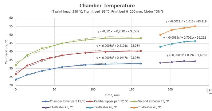

I have made some tests. The temperature reading taken from two probes (see photo) - “T1” lower at the bottom ca 50 mm from door in the left corner and “T2” upper ca 70-90 mm from left extruder at the home position. The third reading “T3” is from right extruder.
The testing was done by heating the left extruder at home position to 230 C and print bed to 65 C at the height of 200 mm from the bottom (ca 10 mm down from extruders). There was no printing (!), so no movement in the chamber. The extruder motors were switched “ON”.
The graph shows the temperature rise during ca 165 min heating. I can see that temperature will not rise anymore, at least not drastically. So, the conclusions:
  • maximum temperature achieved (left extruder 230 C at home position, print bed 65 C, print bed at height 200 mm from bottom) in the chamber (upper part) is 40,5 C;
  • the chamber lower and upper parts temperatures differs by 7,5 C;
  • the second extruder (right) temperature reading is higher (differ by) than chamber temperature reading by 7,5 C.
The second part of the testing (and right part of graph) related to use of additional heater (75W, set to 45 C). After 170 minutes of testing (previous parameters are the same) I have added the heater into chamber. Placed it to the bottom. No fans have been used. The test was continued for 60 minutes (1 hour). Conclusions:
  • the additional heater (temp 45 C) increased the chamber temperature (upper part) for 5,8 degrees and reached the maximum of 46,3 C;
  • the temperature of the chamber lower part haven’t increased significantly, the maximum achieved temperature is 34,2 C or increased by 1,2 C. Difference between lower and upper chamber parts temperature increased by 4,5 C and was 12,1 C;
  • the right extruder temperature increased to max 55 C and was 8,7 C different from maximum chamber temperature achieved.
Have not yet tried heater higher temperatures, should be possible to go up to 70 C. Have not yet tried adding the fan (for mixing the heated air inside the chamber).
One definite conclusion is that air circulation fan is needed, as the difference between temperatures inside the chamber are to big (7,5 → 12,1 degrees). I was experiencing ABS part cracking between layers as print bed was lowering after the printing was finished. That should be the reason.
But it seems that additional heater can be helpful in case of printing ABS, ASA or more challenging filaments.
This is the photo of the temperature probes position in the printer.

But, I have noticed that during PLA printing with part cooling fan (auxiliary) “on” the temperature distributes evenly (difference only 1-2 degrees C) inside the chamber.
This is why I made conclusion confirmed by testing results, that if even the heating of the heat bed (passive heating) is enough to achieve for example 60 C in the upper part of chamber (Miles confirmed it in the post on 23rd December), the temperature in lower part of chamber is still differ significantly. In my case difference was 12 C. I guess then the chamber temperature will rise more the temperature difference (temperature gradient) will be even larger.
The simple reasoning is that hot air will rise and dissipate throughout the top panel and unsealed doors at the top, side panels, as this part are not properly insulated. This is why the top panel insulation is definitely very good idea. I will try it soon also.
It is confirmed by my test results, but I was somewhat surprised by the fact - the temperature of the lower part of the chamber didn’t changed much even after adding additional heater (!). This is definitely insulation problem, as generated heat just dissipates on its one way movement to the top of the chamber. Otherwise the convention of the air (hot air movement and mixing) will happen. It is not a case, definitely not evident here. But there are limitations. The insulation can be made from inside to have aesthetic look in case of top panel, so it is only up to 20 mm of insulation can be used (I have installed top panel riser by 70 mm using printed additional “walls”). It is even not possible in case of acrylic side panels and doors. I do not want to cover them, I want to see what happening inside of the printer.
This is why additional air mixing fan is needed. If placed at the upper part of the chamber the additional fan will “cut off” the hot air movement upwards and direct it to the sides and hopefully downwards. This would allow to efficiently mix air inside the chamber, not “wasting” heated air.
