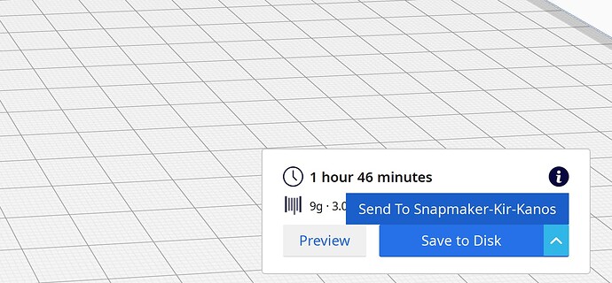

I just use this:
I dont think it acknowledges the machine in any other way beyond this added option that I can remember.
I found this screen under Extensions on the top bar there.
perhaps you could add the IP address manually to the machine to restore functionality.
hmm okay, maybe I can send prints still. I didn’t even try to just do that since the printer wasn’t showing up in the normal add printer or plug in settings. Before when I was using 4.9, it did and I thought I was even able to control things through the monitor tab (like leds, homing, etc)
thanks, it seems to work for me the same. I thought I had some more functionality before, maybe there’s another plugin I lost?
I dont know of a plugin that allowed anything other than this functionality. Maybe you had something working some how but i think this is the best you will get under normal circumstances.
