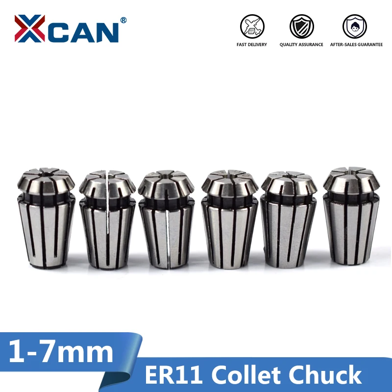

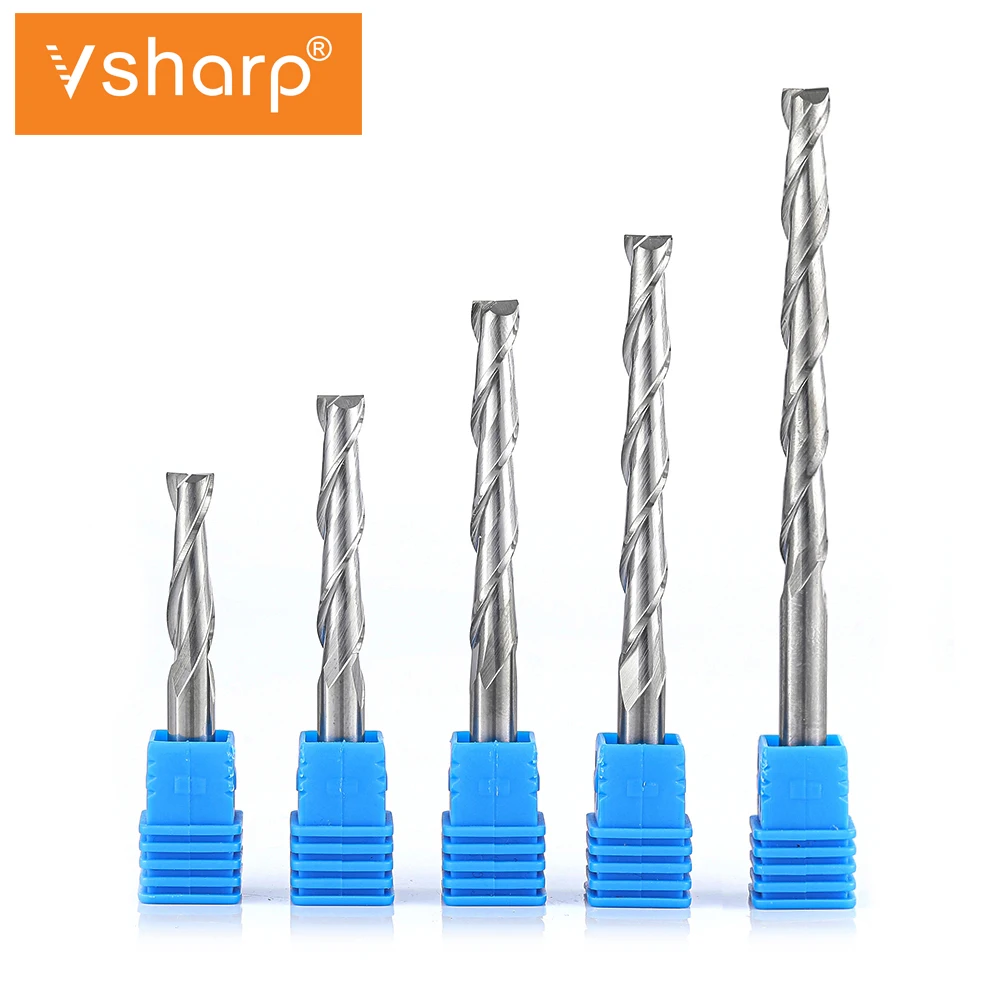

With a 4mm collet chuck and a 4mm Vsharp double flute flat end mill bit, I’m able to get decent results on pine at 500mm/min with 4mm depth.
