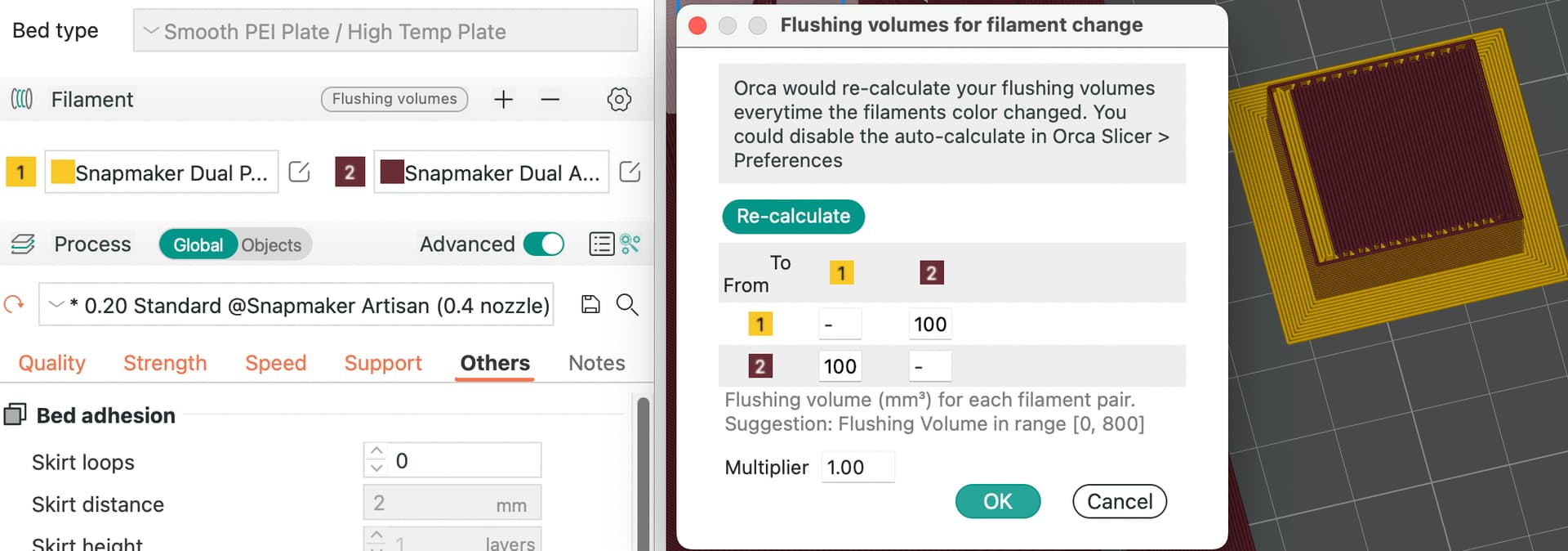

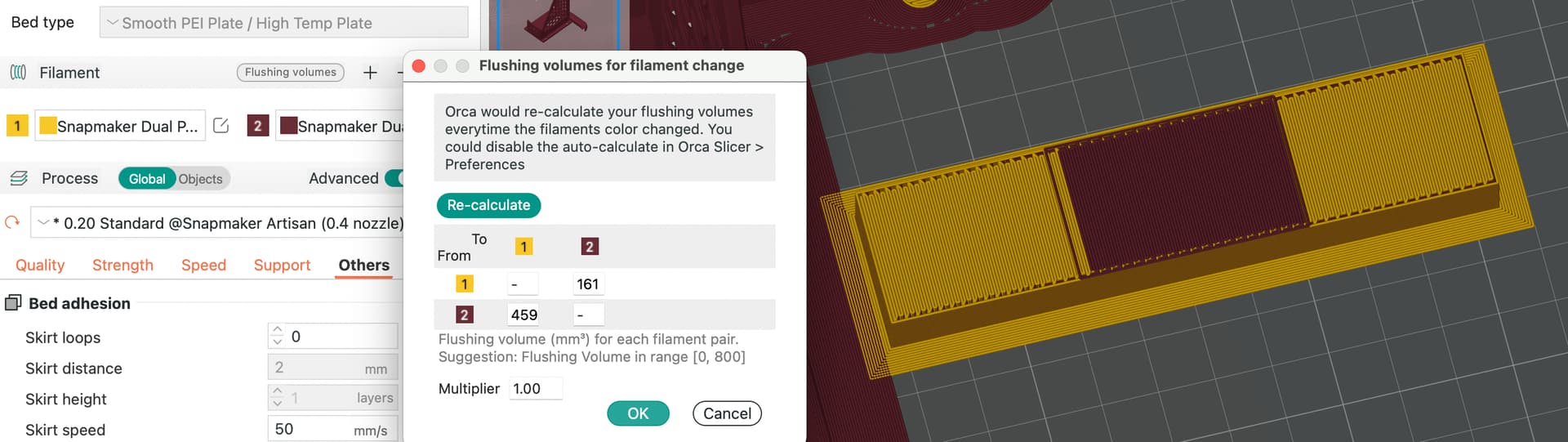

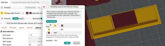

One point of note: the flushing volumes between filament types may not be correct for a dual extruder. You may wish to adjust the values lower, I went with 100 and it makes a nicely sized purge block rather than one which took half the bed and wasted a lot of filament. Default calculation is based on MMU, not DEX.
Defaults (based on the colour chips):
After (manually set):
You can try set the multiplier to 0.2 or less.
This value cannot be written to the preset profile, so it has to be changed manually.
