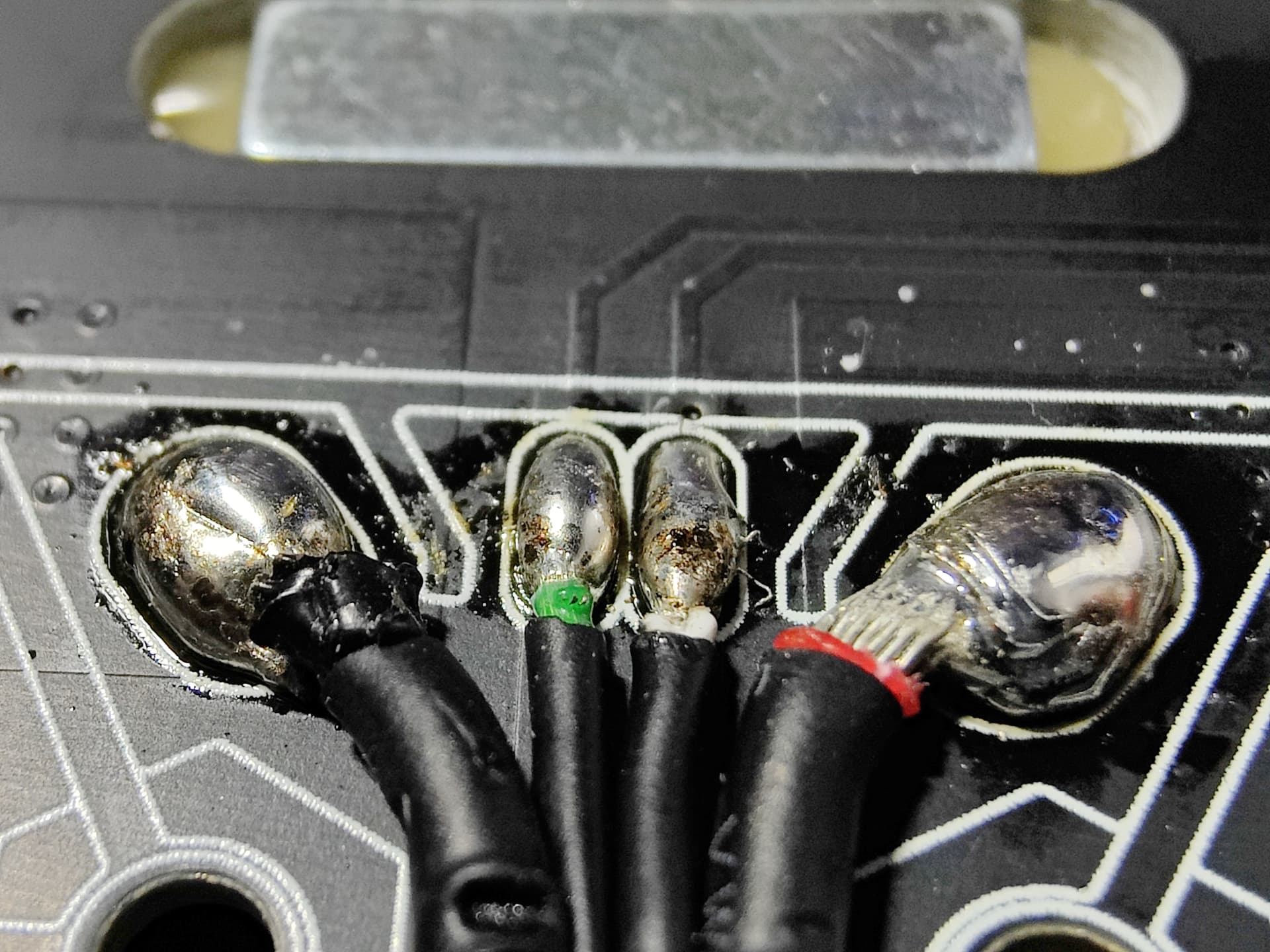

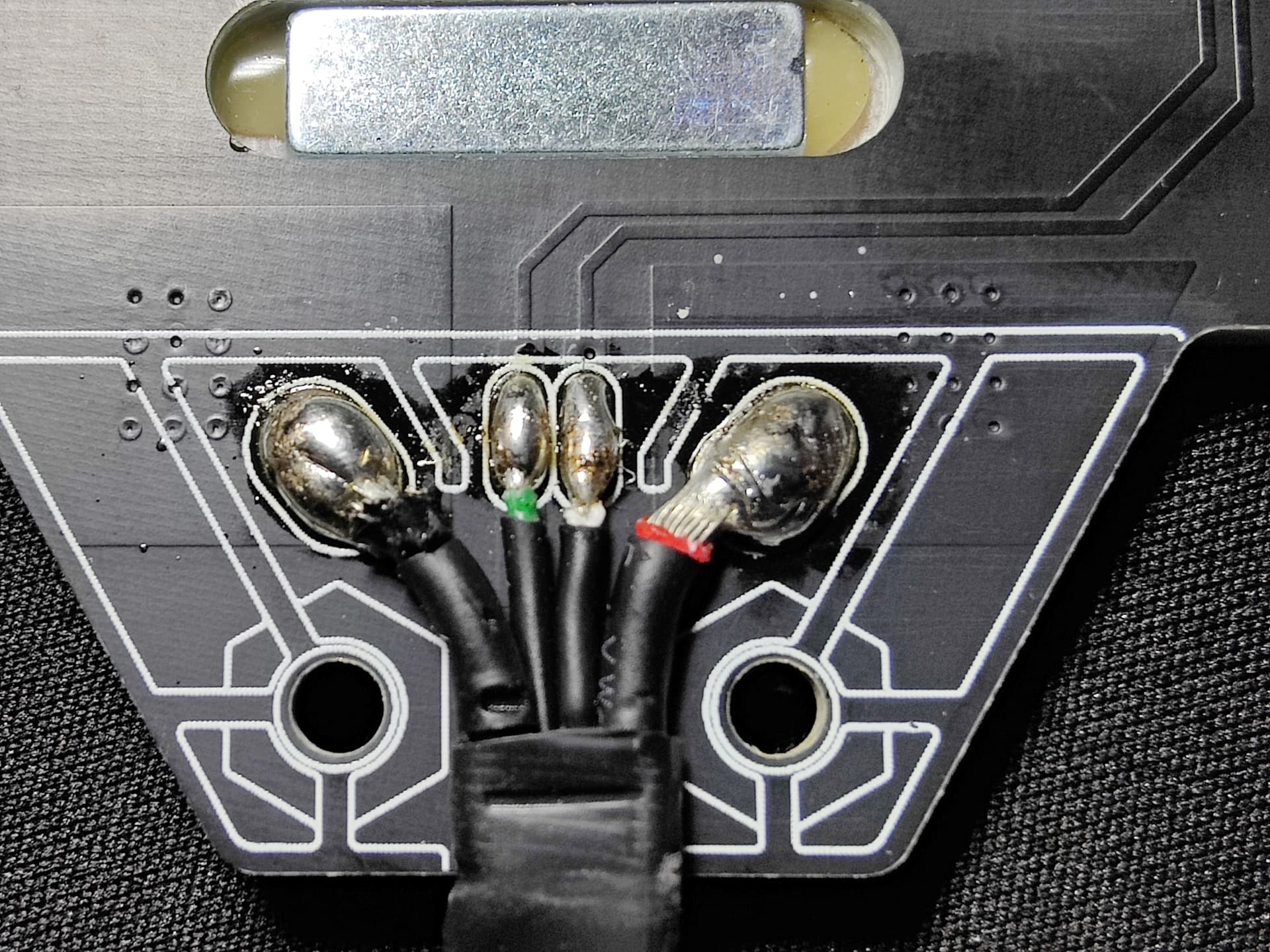

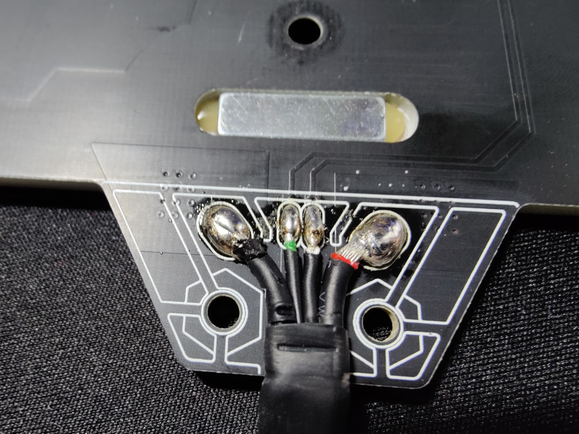

This might indicate a bad connection, especially based on your other observations. While the bed is moving, it sounds like it is making and breaking connection, so I’d guess that the cable is bad. Contact Support, and they should be able to help you. It’s most likely a broken wire where the cable and bed meet.
I have tested the resistance of the heated bed cable.
  • The resistance between Pin 4 and Pin 1 is 2.7Ω.
  • The resistance between Pin 3 and Pin 2 is 100KΩ.
I’ll try to attached pics of the bed cable attachment. Not really seeing anything bad myself.
Support is saying it might be the controller which would cost another $110 to replace since I bought the machine in Jan 2021. If I move the cord around and keep it held up in certain places (like I’m holding an old antennae in the right spot), it will start heating. There doesn’t seem to be anything physically/visually wrong with the cord or where it attaches to the bed but its quite annoying to be paying for a replacement part after 1.5 years and its in perfect shape.

This means that you have a bad connection somewhere in relation to that cable. It could be a connector, the connection of a connector to a PCB, the wiring attached to a connector, or the wiring itself. You should be able to use your multimeter to find the flakey connection.

If you are not seeing the temperature, then the connector on the cable is most likely bad. Moving the cable around as you were, might get it to connect in a certain position. If it does, then you have 3 options, 1) Purchase a new heated bed, 2) Purchase a new cable, cut off one end, and try to wire it yourself, 3) Ask Snapmaker to sell you a separate heated bed cable, which would be a special order.
If you go with option 2, ask Snapmaker which of the cables that they sell is the same length, or longer, than the heated bed cable.

Not sure what to check via multimeter but I have checked resistances in the pins and they seem fine. I posted them above the pictures.

The resistances are not relevant for the issue that you are observing. You should only be caring about continuity, to determine where the connections are broken. Find a connection that is broken, or is intermittently broken as you move the cable around. If it’s inside the Controller, it’s most likely a bad connector, cold solder joint, or broken trace on the PCB.
There isn’t anything that I can help you with beyond this. If you can’t figure it out, you either need to work with Support, or take it to a service center if there one near you. Only Snapmaker can help you at this point.
