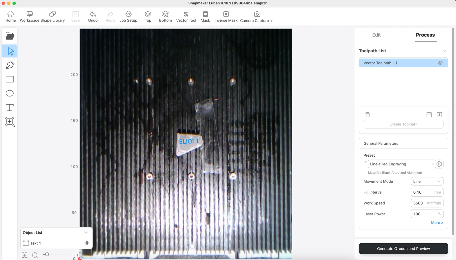

Hello all,
I’ve just tried to do one of the basics…
Laser engraving, of a stone support.
I’ve made a background capture, fine.
I’ve made a shape, a very simple text field, and adjust size/position.
Then just run it from Luban, result :
Why it cannot be simple…
Luban :
Attached, g-code…
Text 1_1704545491453.nc (21.9 KB)
To be sure, what version of the firmware are you on?
The laser power isn’t turned off explicitely in the gcode, however, I think G0 should turn it off, so it might be a discrepancy with an older firmware.

Touchscreen : V1.15.11
Controller V4.5.32
I’ve seen I’ve an update available, I will apply

@brvdboss update done, fixed.
pity than no warning was mentioned, but good to see it was “just” a mismatch.
Glad to hear this has solved the problem for you!
