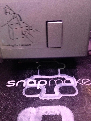

Does this happen when it’s too close or too far?
sorry for the blurry picture.
But you can see it gets wavy and stuff.
Thanks,
Greg
That is a symptom of over extrusion, not calibration.
So I should set the extrusion to 95% or so?
I’m not really sure if it is either. It may just be Cura messing up. Others have reported the same issue. The extrusion seems to be very jolty in when moving left and then down. I’m going to try SnapmakerJS and I’ll get back to you
-Greg
Sooo I fixed my problem.
It was a mixture of many many things. The first thing I did was adjust the z-offset. I found that an increased offset lead to better (but not perfect results). After this, I attempted to decrease and increase the extrusion rates. An increased extrusion lead to better results and a nicer first layer.
Now, the problem still had quite some issues and I was getting fed up. So I decided to calibrate my extruder again, and to my surprise I was under extruding by a whole 10%. I quickly sorted that out and then tried another print but the corners weren’t sticking.
Last ditch effort was cleaning the bed 3 times with rubbing alcohol. And wabam! It finally printed perfectly! I have an even first layer and I can print on the entire surface again!
