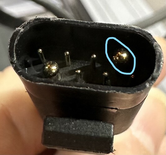

Is your hotend connector correctly connected? (clicked in and have all pins the same lenght? - There are 4 Pins)

I assume you’re referring to the main cable the plugs into the connector at the top of the print module. If yes, then yes, we make sure it gets inserted securely. It doesn’t click though - just pushes in and stops. I checked and all pins are the same length except for one (circled in blue) of the larger ones, which I’m guessing is the ground pin.

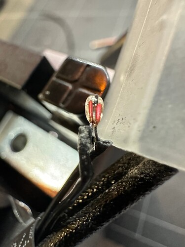

Did you take a close look at the hotend to see if the thermistor is actually in it? Also, check the wires going to the heater. This is where the majority of issues lie. If the thermistor has popped out, reroute the wiring to ensure that it stays in. Be extremely careful though, as the thermistor wires are extremely fragile, and so is the glass bulb.

CNC-Maker - The thermistor was inserted into the hot end as it should have been. I removed it to take these two pictures. See anything amiss or is that how it’s supposed to look?

Second picture…
You should have a spare hotend with thermistor, heatresistor and nozzle in it, change it and see if it helps.
Check the hotend connector before assembling the new hotend.
