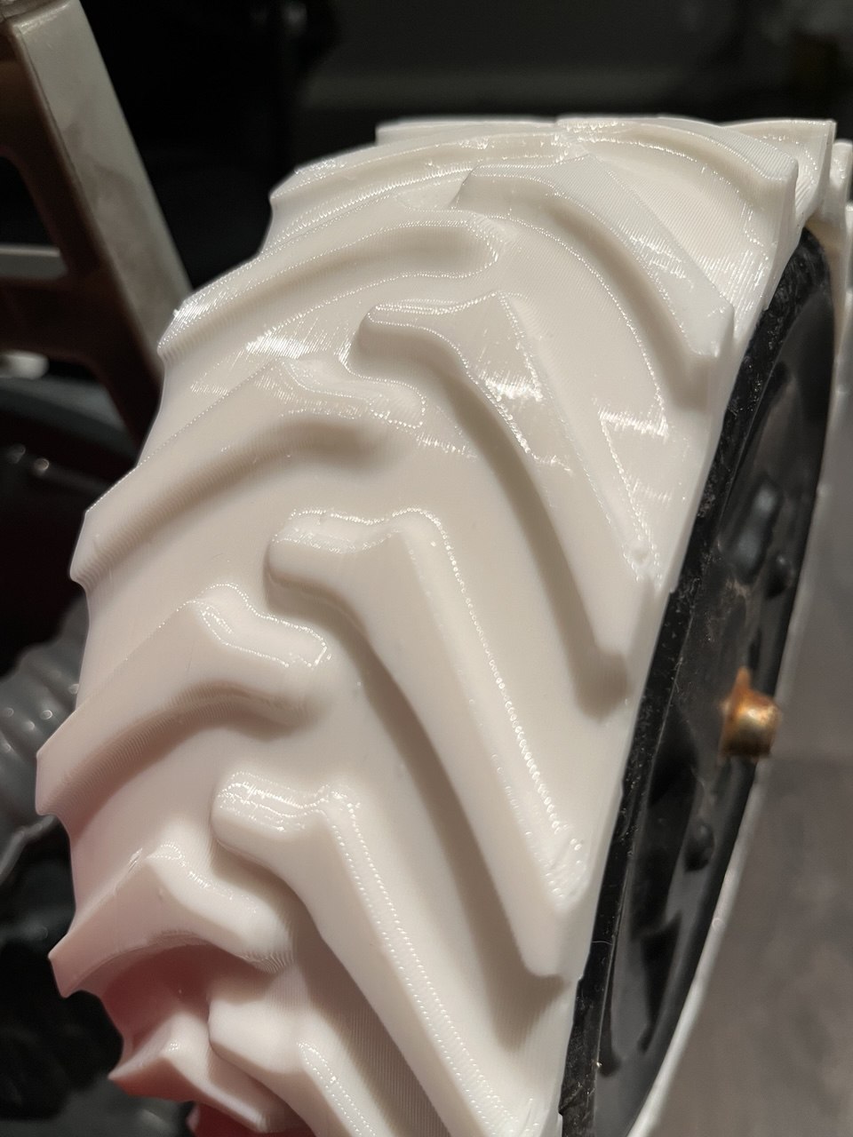

I like dual extruder much much more than single extruder module, I printed PolyMide PA6-GF
and Fiberon ASA-CF08, lots of TPU stuff like tires for my sons kids quadrocycle, diameter 210 mm width 75 mm, around 400 g.
I do not see problems with slicers for dual extruder for two different sizes, I use 0.4 and 0.6 Tungsten Carbide nozzles, even orca can work with it you just need to learn how to use it, with Cura it extremely easy. And yes, I am using enclosure which I improoved a bit
it reaching 55C just from standard heat bed. If you want to print PA you need to think about enclosure, many modern blends of CF filaments claiming you may get away without enclosure but to play safe it better to have one.
I don’t see problems with oozing with dried filaments.
