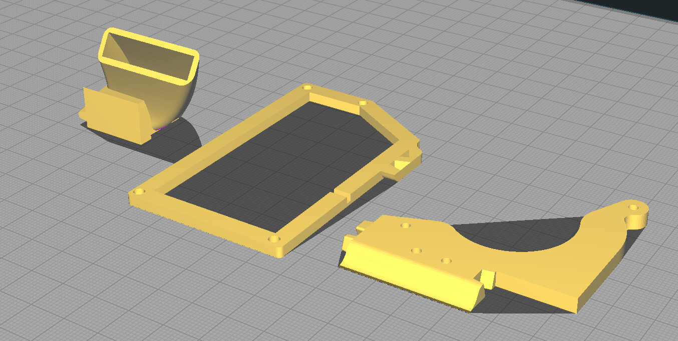

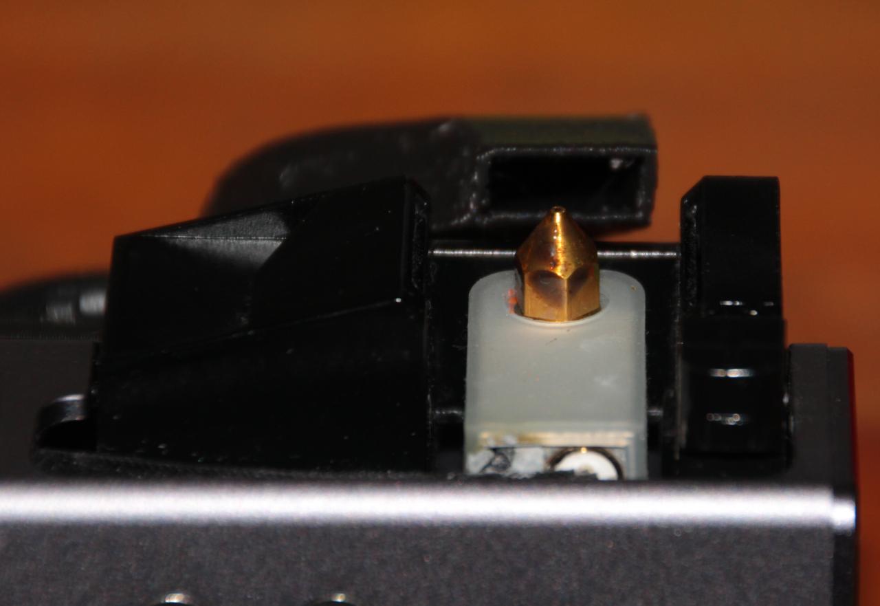

Using my notoriously difficult PLA I did the scaled-down temp tower again, and with the version of the fan mount here from the posts above, the air blew too low for me: You can see it. The left is the old, stock cooling tower, a real catastrophe. The middle is with the files here from the forum. You can see that where the build plate forces the air on the print, its OK, but the higher the nozzle goes, the more I goes back to the old catastrophe (the tower was knocked over at some point). I could feel that the air went too low. So I modded the airguide funnel to point higher, made it go closer to the nozzle and also narrower for a more focused air jet. Now it blows right at the printing zone, and the right temp tower (also knocked over at some point) shows much better results. I guess the ugliness remaining is overextrusion, cooling is now just fine! Thanks for all of you sharing your designs!
I added another two modifications: One is a triangular stabilization surface - it makes any double-sided tape for fixing the fan unneccessary. Second: I did not have long enough screws at my hand, but only 10mm M3 screws. I added stilts with screw holes in them to put the fan onto. Its a bit tricky to get the fan on, but with careful wiggling the fan snaps in nicely!
You can find the STL files on Thingiverse. On Thingiverse, I referred to this forum to make clear that I built upon the work of others - I put license “Creative Commons - Attribution - Non-Commercial - Share Alike” at it - if anyone feels that this is wrong, please let me know!
I printed mine with the flat part that goes at the side of the printhead on the buildplate, the fan mounting plate pointing upwards. This requires a bit of support, but came out nicely. Just make sure that you put no support inside the airguide funnel - you’ll have a hard time removing it! Also, the screw holes in the stilts I’d recommend to do without support.
