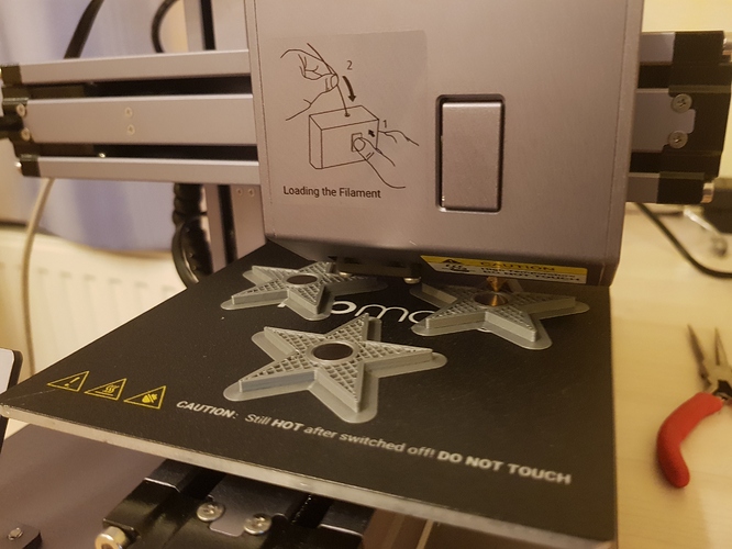

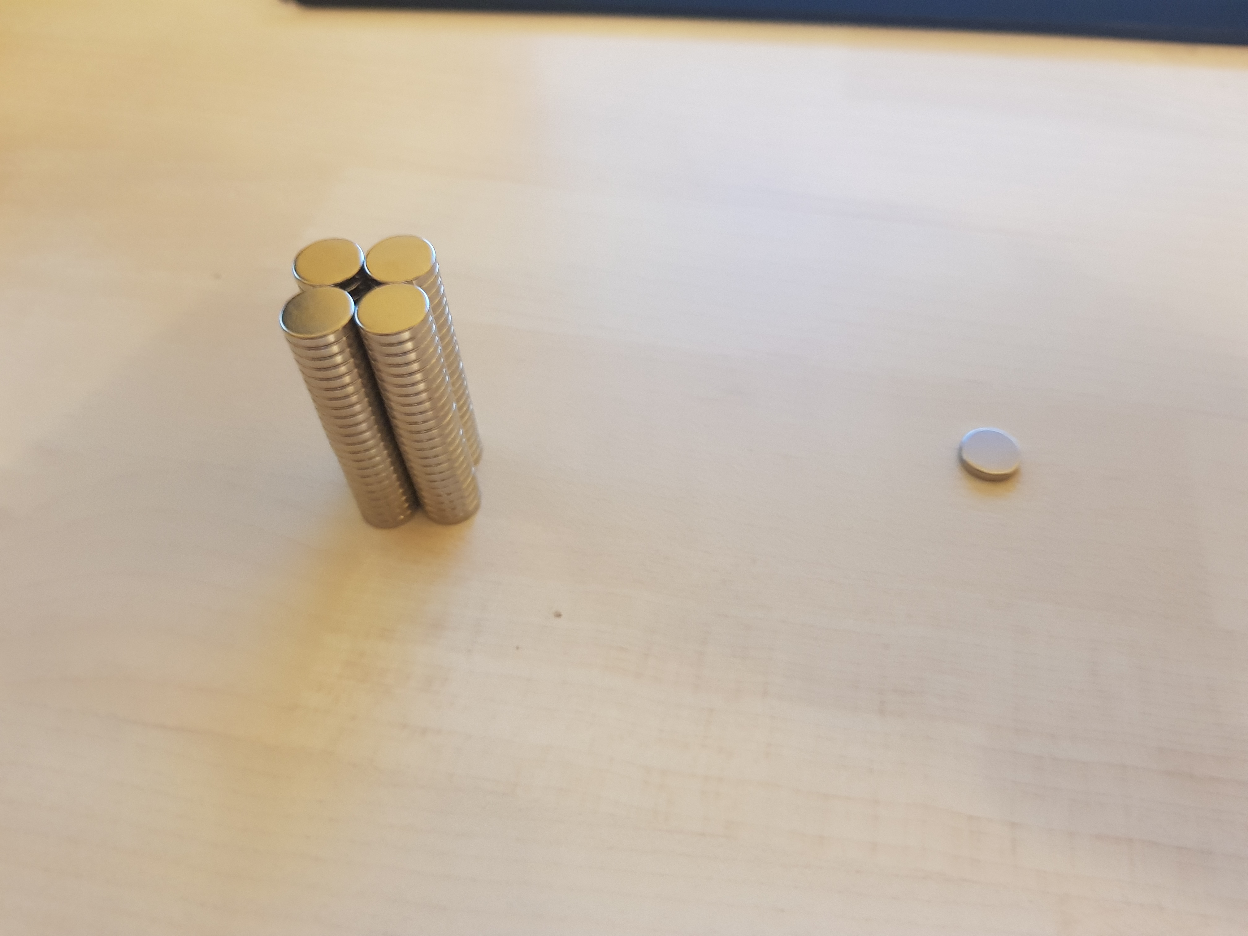

Currently I’m working on some cool inlay work with small magnets.
These magnets (Ø10x2mm) don’t cost more than 20 cents a piece - I bougt 100 pcs for about 18 Euros:
I’m making some presents for christmas and my coleagues at work:
Designs I allready made with magnets inside: stars, hearts, moon shaped objects, company logos,…
Simple as hell and quickly printed.
I always make some copies to have time for laying in the magnetic discs (not possible with Snapmaker3D jet) but if the print is not too small you have enough time - just before the ceiling of the hole is printed.
The hole for the magnet is just 0,1 mm in diameter bigger than the magnet itself so you can “snap in” the magnets. With 0,2 mm air they are a little bit loose and can snap to the fan underneath the printing head (I have a solution for this too but with 0,1mm everything works fine).

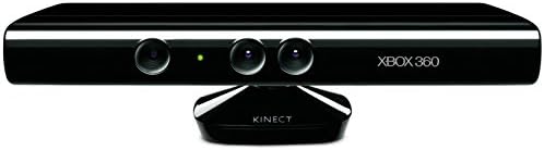

This should get you started:
https://pinshape.com/blog/the-11-best-3d-scanners-on-the-market/
You should be able to pick up a kinect for under $35. No reason to wait for your snapmaker to start scanning.
Ummm $35…? $95…?
Point taken… Perhaps my first SnapMaker add-on module…
william…
$32.99 at the moment of posting this. I guess there also apps that let you use your phone as a scanner too… news to me.
