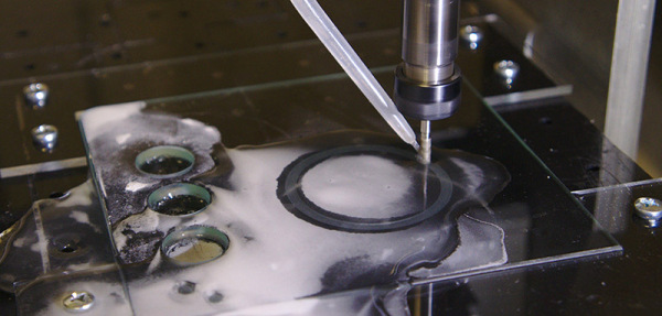

On another note, do you think the CNC would be able to handle this? I would be afraid it would chip the edge and also the edge might be rough and scratch the screen.
If you use a diamond burr I think it’ll work fine. Good idea, I haven’t thought about that before!
Looks like it needs coolant though, which isn’t really compatible with the snapmaker unless well contained, but in theory it seems to work.
Ordinary glass, sure. Tempered glass, maybe. Tempered glass is manufactured with internal stresses that ordinarily strength the glass but also cause cascading failure when it does break. (For an excellent illustration of how you can get both, find some slow-motion videos of a Prince Rupert’s drop breaking.)
I’d recommend a very fine abrasive, and even then, plan on having extra material available to practice on. It’ll be very easy to ruin some material before getting it right.
Do you think it could be done without coolant? Sure would be a lot less worried about getting water on the electronics…
A CNC glass scoring machine seems more practical for the snapmaker
Perhaps. For something as thin as a screen protector, it’s conceivable that you could use air as a cooling fluid.
But that’s not the only problem. If you don’t use liquid coolant when grinding glass, though, you then have airborne abrasive (ground glass particles) to contend with that can cause damage in its own way.
