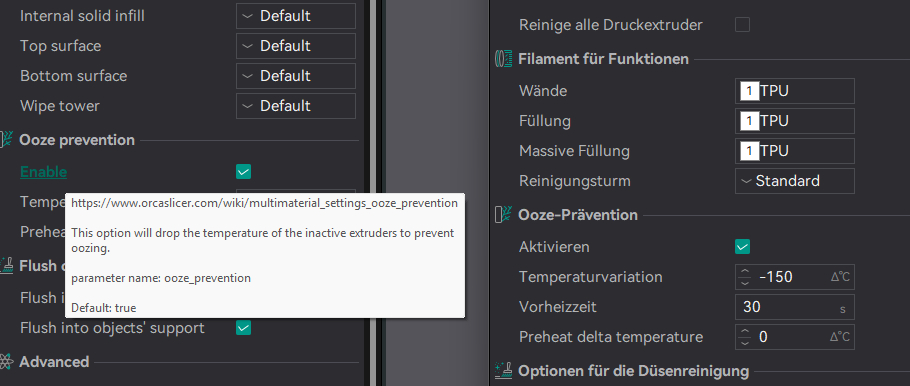

Could this option help? Available in Orca and SnOrca.

Ok that could work! Orca says if ooze prevention + idle temperature at filament settings, this should do the job.
Will test this tomorrow, and report.
