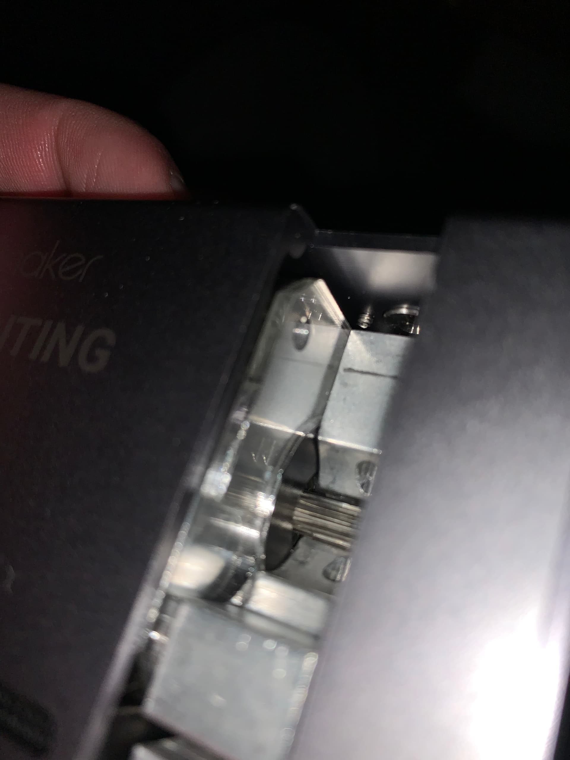

@Hauke its too difficult to tell if the gear is fixed on the motor or not. I only have it apart far enough to do the IR sensor mod, it would require complete disassembly and taking the motor out to know for sure.
The sensor itself doesn’t move when pressed.
Thanks for looking! Would you mind to take a photo like this one, i.e. with the filament guide flap open and at a slight angle onto the stepper/feeder gear? That should show enough to at least have a guess…
@Hauke i just put it back together but hopefully this is good enough.

Thanks for the pictures! To me it seems that they did not change anything :frowning: That’s bad - I expect that over time people printing with abrasive filaments like wood or glow in the dark will experience problems with worn out feeders - I hope Snapmaker will have a good offer then. If you have to replace the printing module each time, that’s not a good answer. Admittedly, I’ve only yet seen one occasion on Facebook of a worn out feeder. Anyone aware of more cases and how they were handled?

@Hauke i actually watched a video of a guy taking apart the head completely and the extruder gear slips right off of the motor.
Oh, really? That would be good news! Do you remember where you saw this video?
