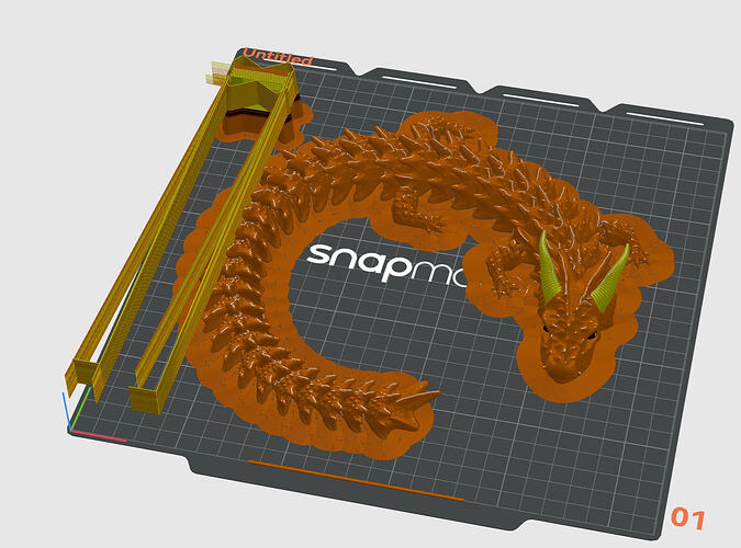

Snapmaker U1: Strange Display of the Purge Tower
After slicing some models, the Purge Tower looks strange. Did I set something incorrectly? Will it print correctly like this?
Somebody reported the same very recently. Please do a search.
Looks like a display error to me, print it and see what happens.
You can turn off the travel-path preview to see if the extra lines are just travel moves.What version is your software?
I am using Snapmaker Orca 2.2.4. Where can I disable the movement path preview?
Under “Options” after slicing, “Travel” is not selected.
Did you try printing?
Not yet. This is a 22-24 hour pressure, so I wanted to make sure I didn’t make any mistakes and then encounter a problem after about 18 hours. The problems only start further up.
Check this out:
OK, if I set the Wall-Type for the Purge Tower to “Cone” or “Rectangle”, the problem goes away. Only the “Rip” setting seems not to work.
