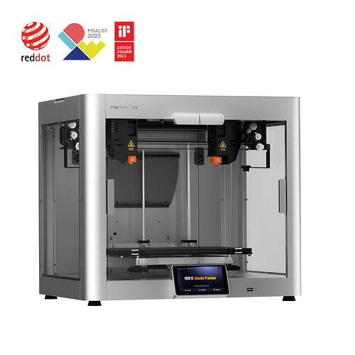

In order to further optimize your user experience with J1, we will release Snapmaker J1 Print Cooling Fan Upgrade Kit on June 15. The extra Print Cooling Fan can set a proper ambient temperature when printing at high speed on J1 and further cool your prints efficiently. Existing J1 owners can upgrade their printers based on their needs. Together with the Upgrade Kit, we will also launch the second iteration of J1 –– Snapmaker J1s on June 15, which comes with a Print Cooling Fan at the back panel as standard as well as pre-installed doors and panels. More info will be revealed on June 1! Stay tuned!

I’m kinda torn since I’ve already rigged up 2 fans blowing onto the build plate from the top-down which cools better than this. But on the other hand I can now keep the lid on.
I just installed the cooling fan upgrade. Easy job… However there are no details on how it is controlled? M106 code? Please let us know!

I’m not sure of the gcode specifics, but a quick test using manual fan speed control is that the cooling fan will match the highest speed of either of the extruder cooling fans.

Firstly, as you may already know, the cooling fan is integrated into the machine design, so there isn’t a separate control for it. The print cooling fan operates in conjunction with the extruder fans. šŸŒ€
Additionally, the threshold of the print cooling fan is actually higher than that of the extruder cooling fans. As shown in the graph below, the print cooling fan kicks into action only when the fan speed setting value exceeds its threshold. However, it also means that the actual total air volume is not linearly related to the fan speed value you set in the slicer. Therefore, fan speed adjustment will require some patience and experience to find the perfect balance for your PETG/ABS/ASA prints.
Now, let’s talk about ABS/ASA printing. By default, the cooling fan is usually disabled for these materials. However, in cases where the ABS/ASA filament is modified, you may need to enable the fan a bit to get some cooling. Since the bed temperature is set above 90 degrees, you can consider enabling the cooling fan at a low speed (within 25%). This won’t significantly affect material shrinkage. A low fan speed setting won’t cause warping. It’s recommended to keep the fan off for the first 3-4 layers and add a Brim when printing large-sized models. Note: This advice is based on experiences with ESUN ABS and Kexcelled ASA.
Moving on to PETG printing, it’s advisable to use the cooling fan in the range of 10%-40%. If you’re using PrusaSlicer or OrcaSlicer, keep an eye out for the ā€œCooling Overhang Thresholdā€ setting. Enabling the print cooling fan for printing overhanging structures can enhance the cooling effect.
