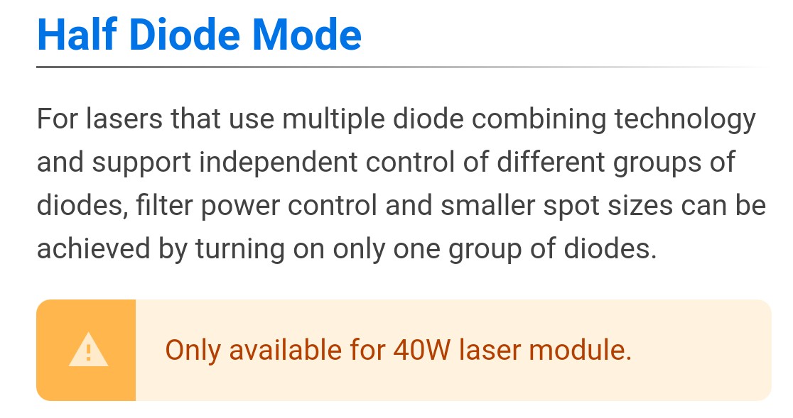

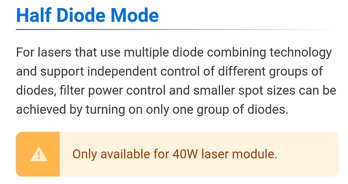

Unfortunately half diode mode is only for the 40w Toolhead available, as it is written in the wiki:
https://wiki.snapmaker.com/en/Snapmaker_Luban/manual/laser_toolpath_parameter
The way the lasers are set up is by collimating and combining the power of multiple different diodes. In the 10W, there’s 2 5W diodes, 20W has 4 5W in a unit, and the 40W has 2 units of 4 5W modules.
So in half-diode mode, it simply shuts down one of the two units, basically turning it into a 20W module. It does not have the ability to turn off the diodes individually, just the stacked units. As seen in the below cutout.
