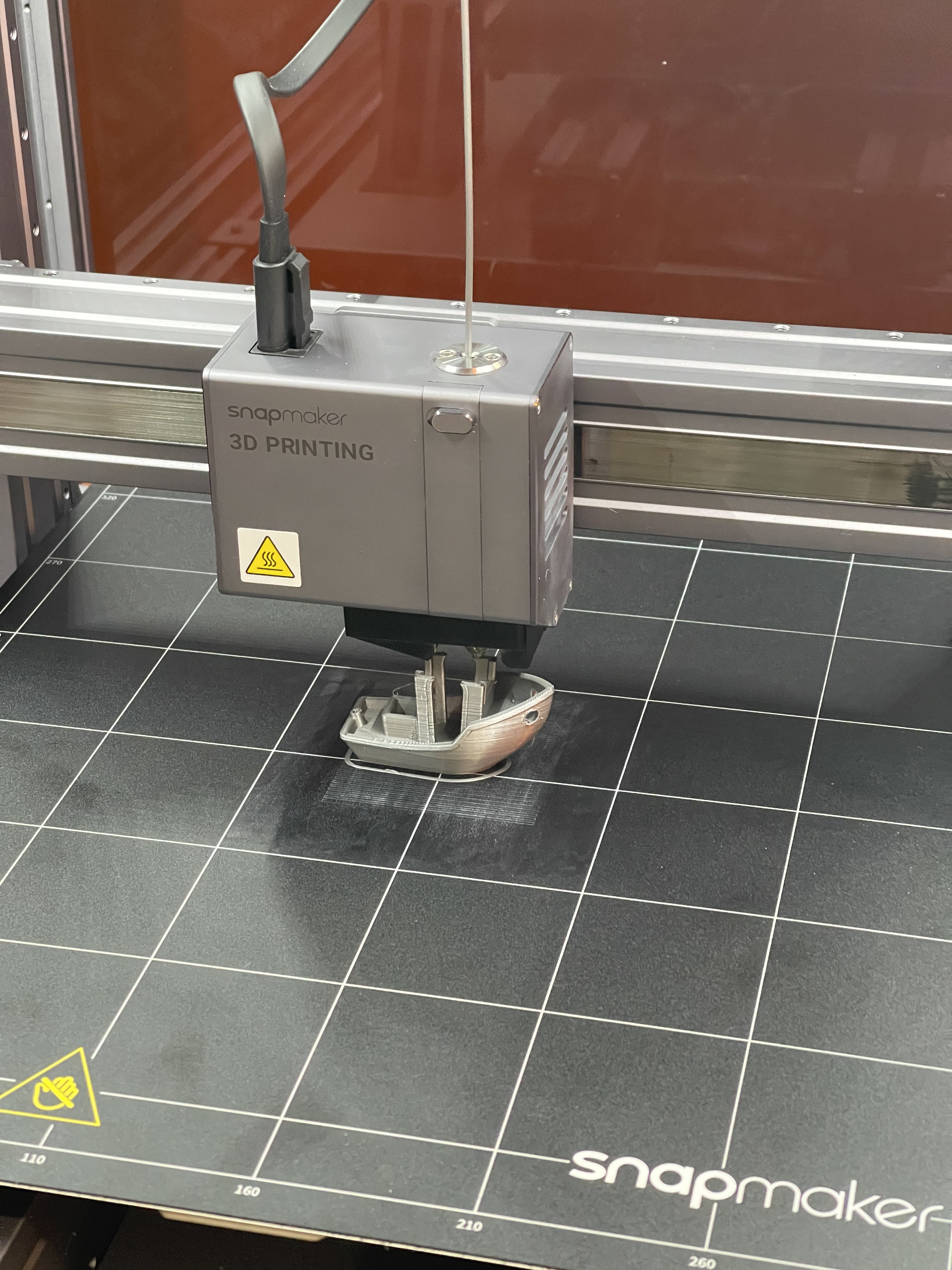

This is my 2.0 A350, using Overture Space Gray PETG. Cura is the slicer (this is 0.16 layer height). Will share my other numbers later.

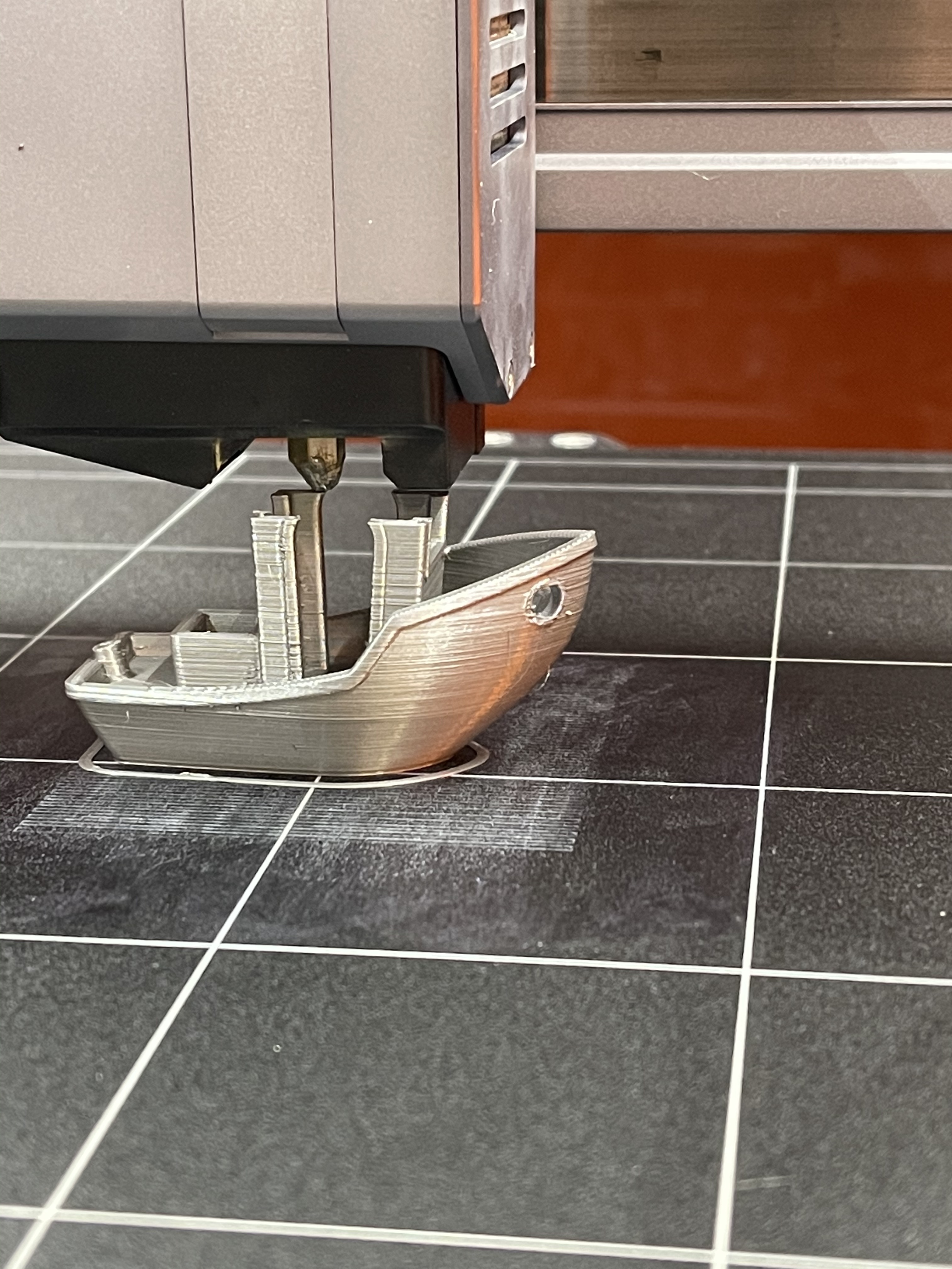

Slightly more zoomed out view to give perspective of the size of the benchy compared to the printhead.
The small amount of stringing you see here is all that was produced—this is exactly what came off the printer, uncleaned. Yes, it was indeed that clean a print with gooey, stringy PETG!

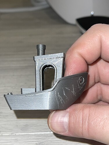

This is not to say it came out perfectly. There are still a few layers that were not quite as clean:
But considering I used no supports, I’m fairly proud I was able to get a print this nice with a 0.16 layer height.
Apologies for the gouges here. My dog liked this benchy so much he chewed on it a bit:
This particular benchy was printed at a 0.2 layer height. I honestly think it’s actually a bit nicer in some respects than the 0.16. What matters to me is that I can print at 0.16 without horrible stringing and blobbing.
Did you output the PET-G directly onto a Snapmaker print sheet and did it peel cleanly?
I think the PET-G sticks to the print sheet and is hard to remove…
Did you find a better way?
As you can see from the second photo, I did print to the Snapmaker sheet. I used a very thin coat of the purple Elmer’s glue stick is all. If you look closely, you can see the hint of it under the benchy.
