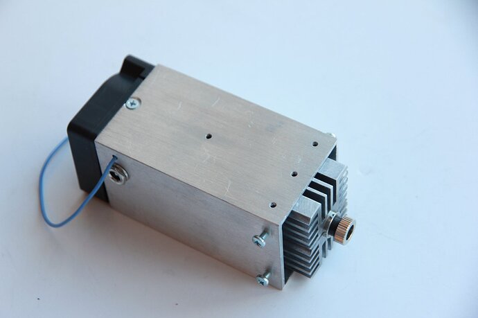

Awesome detective work fellas! Anyone open up the laser module yet? I finally got my a350 and found out that I will need to upgrade the laser to cut thicker wood. Looking at this laser diode, and hopeful that it could be hacked together with the existing module like Frankenstein!
Watching this thread closely
