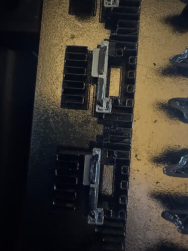

I have now found the solution to my interface issues:
Interfaces with 2 layers on top/bottom, smoothed, and 0.0 Z-distance.
Changed PETG from Generic-PETG (16mm³/s) to 270°C for both model and supports.
Reduced the model base on the supports via Modifier to 30mm/s.
Changed PLA from Generic-PLA to 6mm³/s (probably unnecessary, since the interface is already at 50mm/s) and 250°C.
Now, small interfaces hold on the supports, and the PETG holds on the interfaces.
Gray is the PLA, and on top of it are two ~1cm long black strips of the object. This should be the transition to full speed.

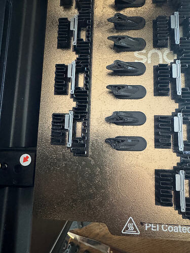

The same with only one layer of the object
Copy & paste it.
I tried another attempt with 5 half-objects without smoothing:

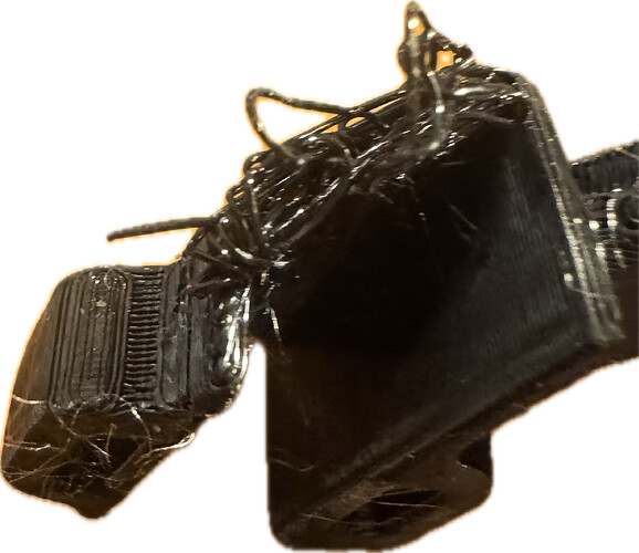

Fail 2 of 5:
