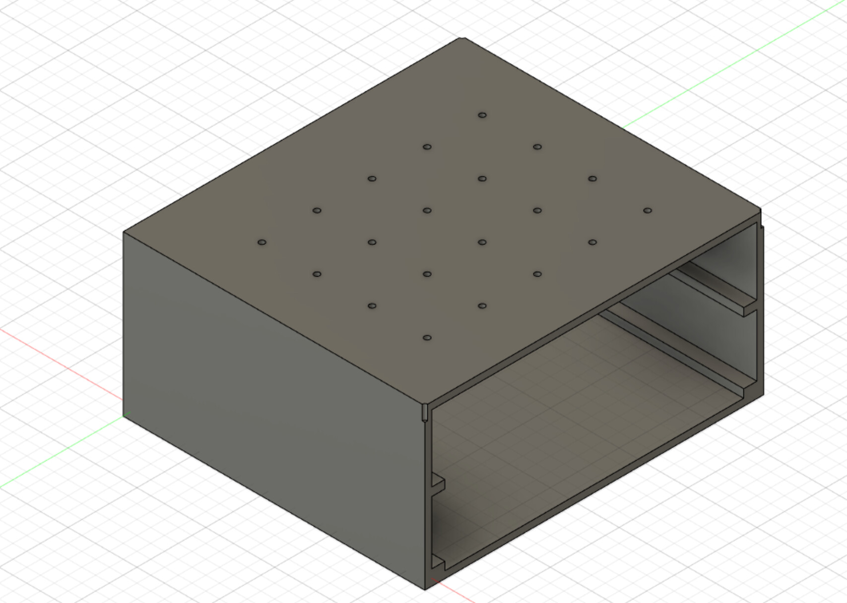

This is the original model i made (first time i had ever used a CAD app).
It was printed with the back surface you can’t see on the bed meaning those holes were vertical on the Y plane. I haven’t tried to see if X plane gives different results… ? The holes ended up 1.8mm tall x 2.2mm wide - the box itself measured +/- 0.2 of a mm on any axis.
And given M92 doesn’t seem to survive power off / on (just saw the other thread) this would have been printed with default 400 value for xyz esteps.

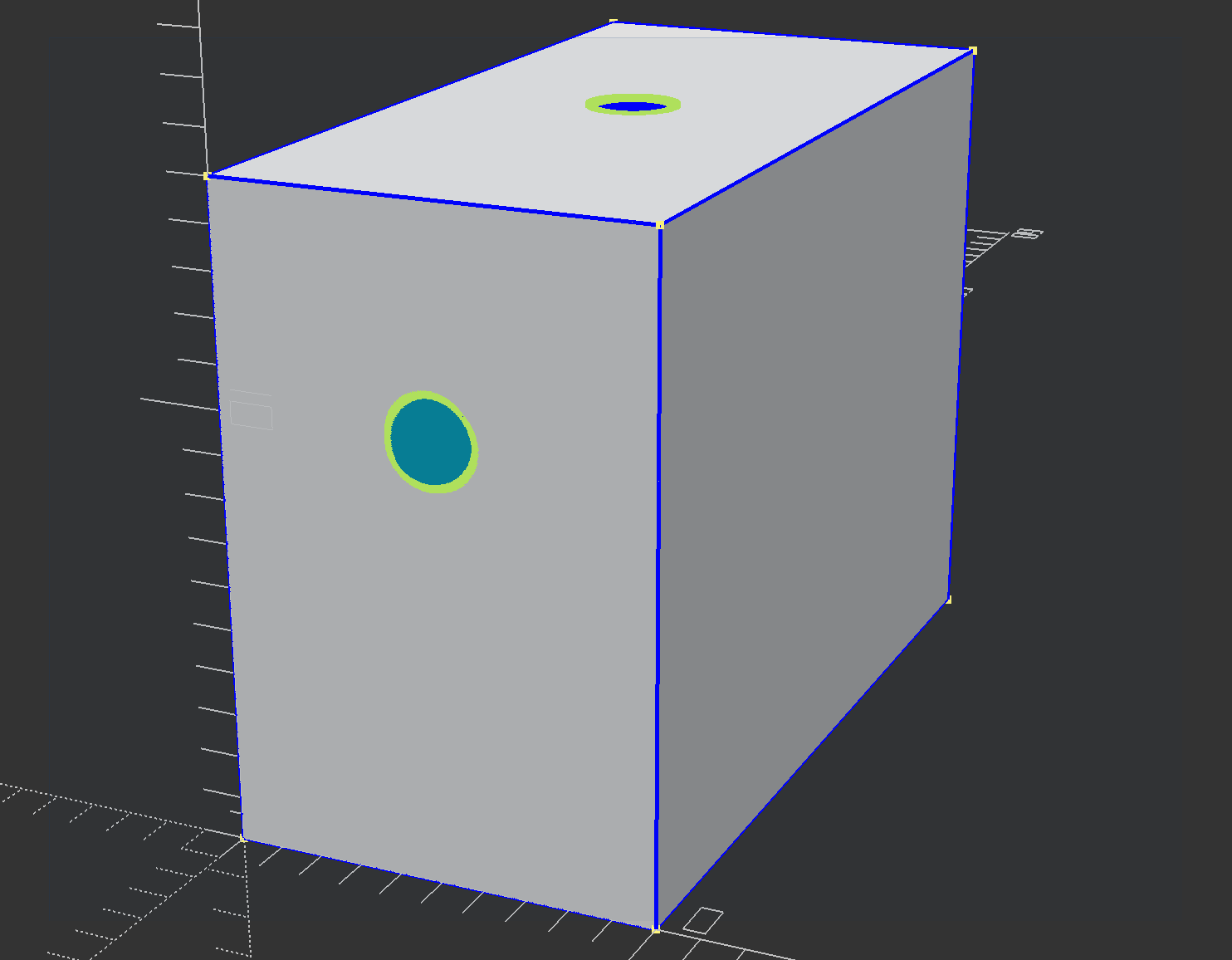

Too late! I modelled this in OpenSCAD to give it a go when the printer is free tomorrow:
line_width=0.4;
facets = (PI * 2) / line_width; //2mm dia
difference() {
    cube([10,20,15]);
    translate([5,10,0])
        cylinder(h=20, r=1, $fn=facets);
    rotate([90, 0, 0])
        translate([5,10,0])
I used circumference to estimate how many facets would be needed to make a hole “round” based on a given line width. Because an STL is just a bunch of triangles, this is not an unreasonable approximation.
To illustrate the problem:
a 1mm line size has embarassingly obvious facets.
an 0.4mm is much better
…but an 0.04mm line width is phenomenal.
Now, the STL file is a triangular mesh that the slicer turns into gcode paths, and these paths are going to be doing what OpenSCAD is doing here: creating facets to approximate a round hole. With horizontally-oriented holes, this would indicate that layer height and line width should be the same value (or that width should be a close multiple of height; extrusion gets weird). With vertically-oriented holes, you only have to worry about line width, and it just has to be small enough for the number of facets (in Y usually) to be large.
That 2mm-hole print turned out to be a pretty good test (well, once I fixed the errors in the OpenSCAD code).
The horizontal hole printed out spot-on at 2mm, but was not quite round. The vertical hole was very round, but only 1mm - I’m guessing that was a perimeter wall setting having the minimum number of walls too high.
